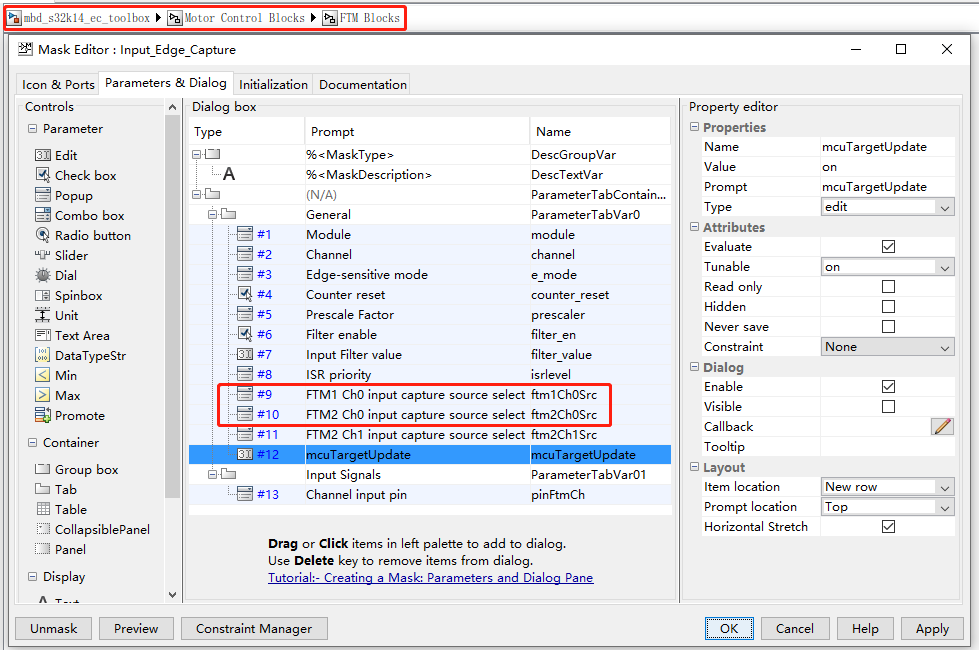

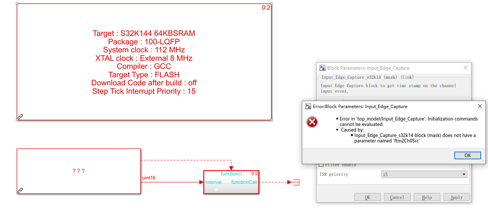

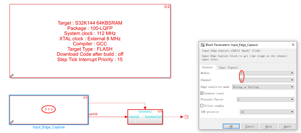

2. Input_Edge_Capture: When I config FTM2 channel 0, it exist exception.
appearance:
 solution:
I can not able to fix this bug, because I do not have acess to change Matlab P-code.
I add a para to the block, it seem works correctly. But it is strange that FTM1_ch0 & FTM2_ch0 & FTM2_ch1 need a para.

Hello deealen@outlook.com‌,
Thank you very much for your effort in discovering this issue. This is now tracked  internally as AST-1408 .
Please replace the following files and tell me if the problem persists
The p coded file must be replaced in S32K\src\mbdtbx_s32k14x\mbdtbx_s32k14x\mscripts\ftm
The tlc file must be replaced in S32K\src\mbdtbx_s32k14x\mbdtbx_s32k14x\blocks\ftm
Please provide a feedback if the fix worked.

Hello mariuslucianandrei
Thank you very much for solving this problem for me.
After replacing the two files in your way, it works very well.
