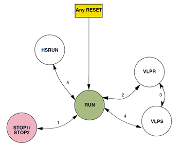

The following diagram shows the power mode transitions. Any reset always brings the chip back to the Normal Run state. In run, stop modes active power regulation is enabled. The VLPR modes offer a lower power operating mode than normal modes. VLPR is limited in frequency.
Power mode state transition diagram (S32K1xx Series Reference Manual, Rev. 4, 06/2017 pag.969)
