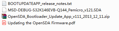

You are right, it is possible to download MBDT code to evb with S32K DS, but it will waste some time compared to direct download. If possible, I still want to build directly with simulink. As for the opensda update you mentioned, I downloaded the update package. The bootloader version is lower than the one on the board. Then I updated the opensda application file according to the evb manual, but the result is the same. Other than that, is there any other way?
The following figure shows the board information and update package information.
