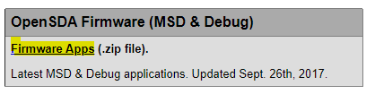

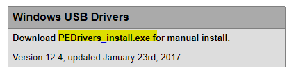

mariuslucianand
Hello chrisc@rmlgroup.com‌,
Indeed you are facing a strange behavior of the board. But, from the detailed explanation, I assume that the controller is fine, but there is an issue with the OpenSDA.
If I had these issues, I would try the following approaches:
1. Install the PEDrivers. Go to PEmicro | Experts in Embedded tools for Flash Programming and Development  and under Windows USB Drivers there is the PEDrivers_install.exe. Please install the driver and check the board behavior.
2. If the driver installation does not solve the issue, then I would try reprogramming the OpenSDA drive, and this can be also a good thing to be sure that it runs the latest firmware: V1.19.
This is a very simple process: Go to the same PEMicro page, and download the Firmware Apps. In the archive locate the MSD-DEBUG-EVB-S32K144_Pemicro_v119.SDA file and extract it on your PC. On the S32K144 Board, change the J104 (the one next to the USB socket) to the 1-2 position. Unplug the board and while you are holding the RESET button pressed, plug in the board. A new BOOTLOADER drive should be mounted. Now copy the .SDA file to the new bootloader. When finished uplung and reconnect again the board. Don't forget to set the J104 to 2-3 position. You cand find more about this process in this User Guide https://www.nxp.com/docs/en/user-guide/OPENSDAUG.pdf  chapter 2.1 and 2.2
Let's see if this helps!
