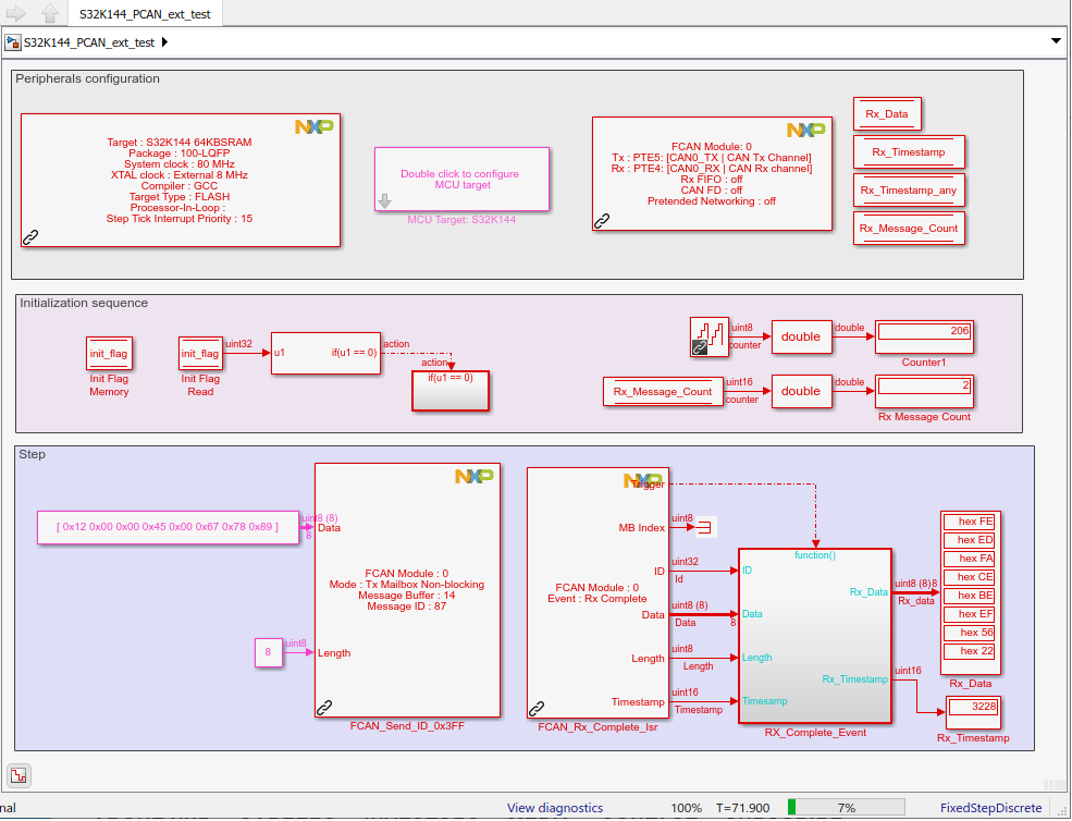

We would like to have the S32K144EVB board communicate with the MPC5775B EVB through CAN Bus messages, and initially, run our code on the S32K144EVB through Processor-in-the-Loop (PIL) simulation mode.  See attached ZIP file with the following models:
S32K144_FCAN_ext_PIL_test.slx  <== tries to run model in PIL Simulation Mode, crashes
S32K144_PCAN_ext_test.slx   <== runs with both Rx and Tx in External Mode
S32K144_FCAN_ext_PIL_test_2.slx  <== run model with FCAN blocks commented out in PIL Simulation Mode, succeeds
S32K144_PCAN_ext_test_2.slx   <== has FCAN Tx Mailbox and Rx Complete blocks commented out, to help isolate cause of crash in PIL Simulation Mode
The model below, derived from NXP example models from the toolbox, builds and runs in External Mode, with inbound CAN Messages (ID=0x88) updating the displayed Data and Timestamp values, and incrementing the message received count, and on PCAN-View we can see the Tx message count increases at the rate of 10 per second.

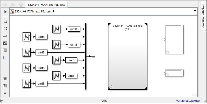

If we run the above as an included model and PIL Simulation Mode for the above included model using the top level model shown below:
It crashes on the board as soon as execution starts. Timeout errors in Simulink warn the application may no longer be running. The PCAN-View Tx message counter stops incrementing, confirming the application is dead.
To determine which blocks were involved in the crash, we tried commenting out subsets of blocks to see which, if any, when commented out, avoids the crash. Both the "FCAN Tx Mailbox" and "FCAN Event Rx Complete" have to be commented out for the application to not crash.
Can anyone tell us why the two FCAN blocks might crash the application in PIL Simulation Mode?

In PIL mode, the generated code is cross-compiled for the target hardware and runs on the target processor. Simulink sends stimulus signals to the code on your target processor through a communication channel for each sample interval. PIL simulation generates the standalone code interface. So if you can deploy your code on target hardware as a standalone executable without problem, then we can rule out the possibility that the deployment code is causing the crash. Therefore, it is highly possible that the code that handles stimulus signal is root cause.
How PIL works: https://www.mathworks.com/help/ecoder/ug/about-sil-and-pil-simulations.html?s_tid=srchtitle#brr9tb5-...
Code interface in PIL: https://www.mathworks.com/help/ecoder/ug/about-sil-and-pil-simulations.html?s_tid=srchtitle#brutuzj-...
I found a MATLAB class target.CommunicationChannel which looks promising in helping you get information about communication channel used in PIL. Unfortunately this function is introduced in R2020b and is not available in your current version. If you would like to try R2020b, you can try follow steps in the link below to set up PIL connectivity with your hardware.
target.CommunicationChannel: https://www.mathworks.com/help/ecoder/ref/target.communicationchannel-class.html
Set up PIL connectivity with your hardware: https://www.mathworks.com/help/ecoder/ug/set-up-pil-target-connectivity-by-using-target-package.html
