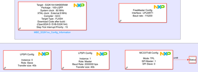

I'm trying to perform model based development with S32K144EVB and MC33771BTPL (MC33664 as mediator). The FRDM33771BTPLEVB is connected with a 12 cell battery module.
Hardware used:
MCU - S32K144EVB
SPI to TPL - FRDM33664BEVB
AFE - FRDM33771BTPLEVB
The following is the pin configuration between MCU and MC33664:
MASTERS32K144EVBPinsFRDM33664BEVBPins
SINPTD1J6-02N/AN/A
SOUTPTB16J4-12DATA-TXJ2-08
SCKPTB14J4-08SCLK-TXJ1-09
PCS0PTD3J1-14CSB-TXJ1-14
SLAVES32K144EVBPinsFRDM33664BEVBPins
SINPTB3J2-09DATA-RXJ2-19
SOUTPTB4J2-07N/AN/A
SCKPTB2J2-11SCLK-RXJ9-07
PCS0PTB5J2-05CSB-RXJ9-05
The FRDM33664BEVB is connected to FRDM33771BTPLEVB  via twisted pair wire
MATLAB Simulink MBDT is used. I followed the example and made changes for use with  FRDM33771BTPLEVB
I see the LED blinking in FRDM33771BTPLEVB but the data in FREEMASTER is 0 (pack voltage). The status is showing 8.
I feel that I'm making some mistake in the pin connections. Kindly help. Also what does the status trying to convey.

Other pinsS32K144EVBPinsFRDM33664BEVBPins
 5VJ3-09VCCJ9-10
 5VJ3-09VCCIOJ9-08
 GNDJ3-11GNDJ9-12
 PTB0J4-05ENJ2-18
 PTB1J4-07INTBJ1-8
Other pins are connected as above.
