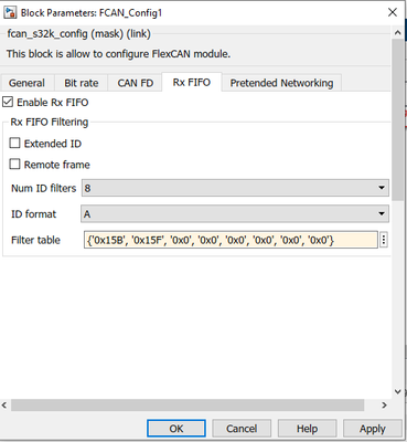

I am trying to receive multiple CAN messages ( multiple IDs) using RxFIFO of CAN Module,
but all the time it is receiving only 1st ID that I am entering in Filter table of config module.
As per my understanding, every ID mentioned in Filter table should create ISR trigger of FIFORx.
Can someone help me??
