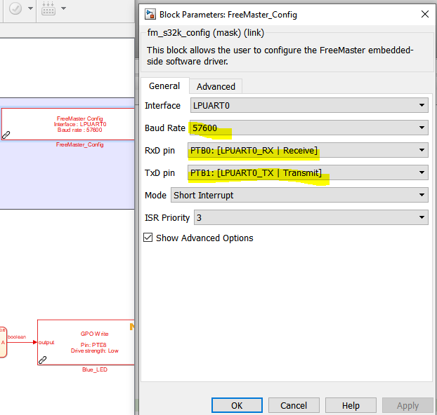

1. The FreeMaster might be set to use other pins. For S32K118 the LPUART connected to the OpenSDA is LPUART0 PTB0 and PTB1. So please check that.

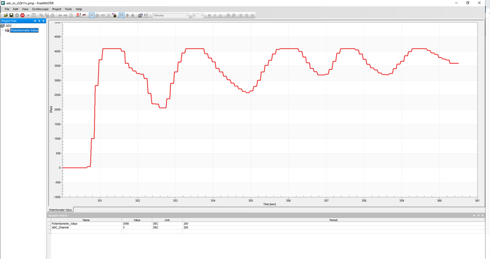

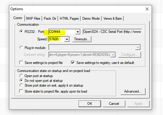

2. The Baudrate has not been set the same in the FreeMaster and Model. I tried the adc_isr_s32k11x example, and here the Baud Rate is set to 57600, so go to FreeMaster project, identify the right COM port and set the Speed to 57600. For me the Port is COM44 but will differ from yours.
Most likely the BaudRate is mismatched!
