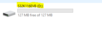

When you connect the board to the host PC a new drive PC should appear on your Computer ( I don't have right now an S32K118, I will use S32K116). If not, please contact your System administrator, or try another USB port ( we faced this issue before)
Now, using this method, Simulink will copy the .mot generated file (is generated automatically from the .elf) into this drive and the Open SDA chip on the board will flash the controller. From your screenshot, you are using this in the gpio_ISR_control example. Also, on the S32K118 make sure you select the 64 pin package, I think this one is on the board.
Also, just for testing, you can copy-paste by hand the .mot file on the mounted disk.

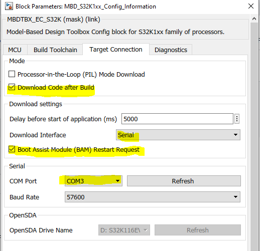

2. using RappId bootloader.
Indeed you have to flash that .rbf file on the board using the S32DS. This bootloader uses the UART connected to the USB to wait for the program on the serial for a couple of seconds after boot. In Simulink, the following settings must be performed:
Make sure that you have the Download code after build and Boot Assist Module ... checked. The first one is obvious what it does, but the second one, is very important. If will show a popup just before the code flashing process will start asking you to press the EVB reset button and within 5 seconds to press Ok on the popup window.

Thanks for answering my question. I received a S32K144 evaluation board from NXP SG today. So I was swapping the S32K144EVB for testing the "gpio_s32k144" MBDT example. However, I still facing the communication issues between Method 1 and Method 2.
1) OpenSDA
I have properly set the OpenSDA to F drive at MBD_S3214x_Config. While I perform the code generate the .mot file will be auto saved it on my F drive (See attachement - Drive_mot). You can review my settings on this example (See attachment - MBDT). It supposed to load the program after execute the code generation and the S32K144 should auto toggle the RGB -  Blue LED (PTD0) according to the state-flow implementation. However, I realized that near the "reset SW button" there's a RED LED was hold-on after the code generation is executed. By the way, S32K144 still does not respond to the program code that I loaded.
2) Rappld bootloader.
Another example called "flash_bam_S32k144. I was also trying to use the Rappld bootloader utility to import .rbf file and the .rbf documents was provided by the mathworks the file path is called " .........mathwork/......../tools/bootloader/RBF files" (see attachment - RBD_Files). I clicked on the browser button and selected the rbf file called " S32K144_S32DS_UART0_CAN0.rbf" (see attachment - RappBL). The operation setup, I tried three operation setup either " Read MCU memory" , "Erase flash only" and "Erase and Program" when I press the start bootloader button and the bar status will loading for a few seconds and then popping out a power cycle error messages (See attachment - cycle_power_error).

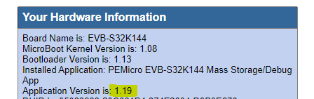

The second thing I am interested in is to open two files from the mounted device:
1. LASTSTAT.TXT - I am interested in the status
2. SDA_INFO.HTM you would get a webpage with similar content as below.
