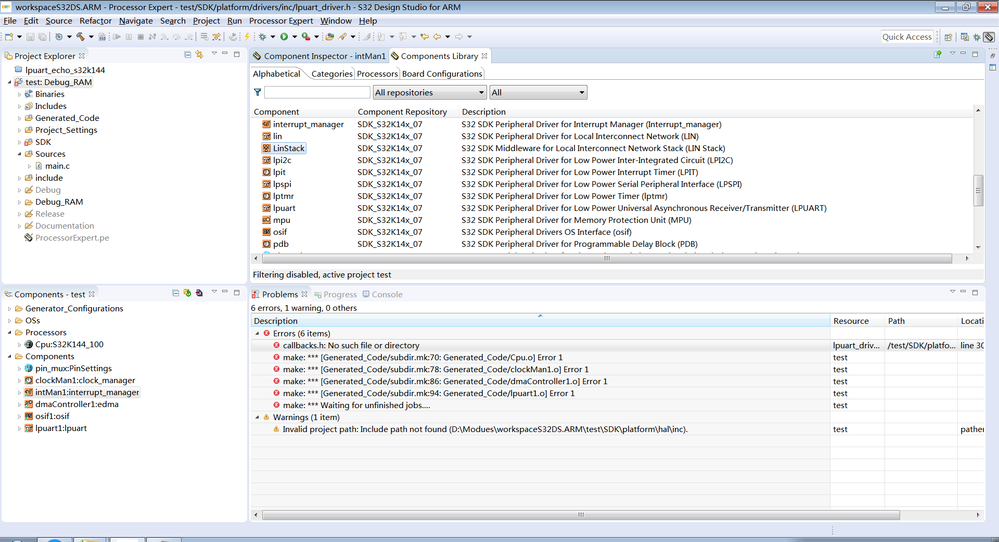

Just like title. In S32DS config the lpuart for chip-s32k144.I add the library lpuart and build, the error like below:
Please advice.

Unfortunately in this community we handle questions regarding MATLAB/Simulink and our toolbox; for S32DS questions you can  try the S32 Design Studio  community. To me it looks like some paths to the SDK are broken. You can right click on the project and go to SDKs option - from there you can manage all the SDK paths associated with this project. You can add/edit from there, if that is the problem.
Hope this helps,
Razvan.
