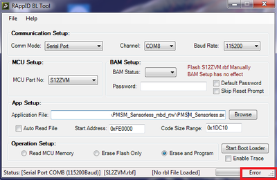

Dear MBD-Team,
after the S12ZVM.rbf is successfully flashed with CodeWarrior/Flash Programmer, I tried to flash application file *.sx with RappID Bootloader Tool, without success. The RappID Bootloader Tool shows  "Init / Erase / Error"

I have 2 questions:
1) Is there a How-To / Step-by-Step / Getting Started... documentation for this evaluation board?
2) When to use the Jumper J10 ?
