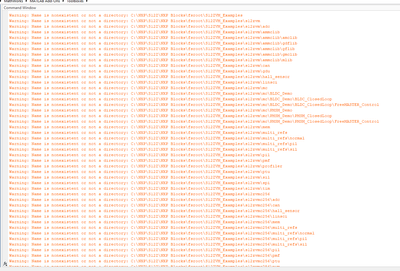

I have installed the NXP_MBDToolbox_S12ZVMx Version 1.4 but this is not showing up in my library browser.
This is causing errors when trying to build.

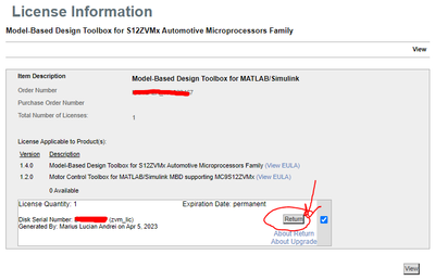

I am sorry that did not work! I think it will be a good idea to try regenerating the license.
First, you have to go to the S12ZVM License information and Return the current license.

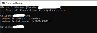

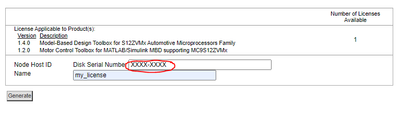

Now, please go and generate it again, You need to specify the Host ID of your Local Disk. To find the Host ID, please open the Windows command prompt (cmd.exe) and type the "vol" command. Now, this will return a code from 8 digits. I have replaced mine with XXXX-XXXX.
Please let me know if this helped.
