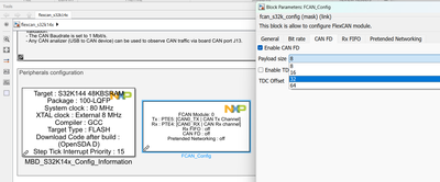

I am working with S32k144 and s32k344 boards. I have already implemented normal can 8 bytes communication for automotive use cases via s32k144 board. But now when i try to work for 32 bytes of data transfer over nxp mbdt toolbox along with Vehicle network toolbox support, i couldn't get the data out in my TS masters/canoe platform. Virtually inside MATLAB i am able to receive it. Kindly make sure if its nxp mbdt over Simulink supports 32 bytes of data transmission via can fd or not? if so do provide me some links to refer please.

In case of S32k144, please confirm that you have tried setting the payload size to 32 bytes in the FCAN_Config block, like this:
For s32k3xx the CAN communication can no longer be configured from the Config block but using a configuration project: EB Tresos or S32 Configuration Tool.
