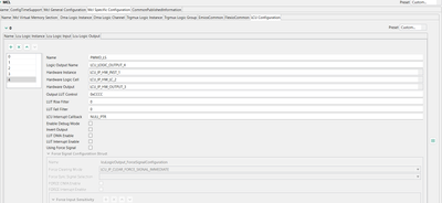

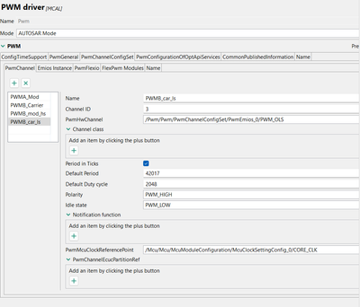

MN_TL_24
Hello Nxp team,
We are also working in Pwm_trigmux_lcu to generate the pwm pulse in Lcu pins.
And we have checked the model given by nxp team "s32k312_pwm_lcu_mod_carrier_s32ct.zip" and we have also used 'PTA0' as the High side pin
but we need to configure the 'PTC10' pin as the Low side pin, but we can't be able to see the waveform in Ptc 10 pin.
we have attached the photos by steps of which we configured.
Step-1: Pin configuration
Step-2: Pin config in port driver
Step-3: Pwm driver configuration
MN_TL_24_2-1731999753141.pngMN_TL_24_2-1731999753141.pngMN_TL_24_3-1731999761421.pngMN_TL_24_3-1731999761421.png
Step-4: Trigmux configuration for Ptc10 (Lcu1_out11)
Step-5: Lcu_instance configuration
Step-6: Lcu logic input config
Step-7: Lcu logic output configuration
Kindly check this configuration, we think that we have made some small mistake in this.
We want to generate High side pwm pulse in "PTA0" - this is ok
and Low side PWM pulse in "PTC10" - this we tried but the waveform is not able to view.
Kindly help us to resolve this issue.

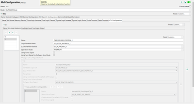

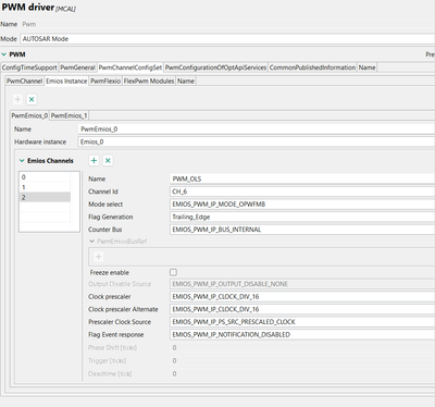

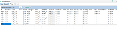

stefanvlad
Hi @MN_TL_24 , @Vijay98
Thank you for reading the post on: Re: Pwm_delay_in_trigger_pulse - NXP Community
The pinout configuration in that thread is for enabling the Logic Cell 0 with it's corresponding pins.
Unfortunately, the pin PTC10 is tied to another Logic Cell 1, Output 11, namely LC1_Out11, as state in the Pin Manager:
What output pin from LCU0 do you want to generate on the PTC10 pin? From my understanding you want to output PWM_Modulator from PTD2 on the PTC10 pin.
We can check what options we have for that PTC10 in Pin Manager, there is an option for emios_0_ch6:
We can use it as this and add another eMIOS channel in PWM driver, EMIOS_0 and CH_6:
Then we add another PWM channel:
Then we need to enable it in Port peripheral:
After this we need to Update Code and save configuration, and modify the Model to update Duty+Period on the new channel:
Save the model and Build , and program the board, we get the new eMIOS PWMC_Modulator on the PTC10 pin:

Vijay98
Hello Nxp Team,
Currently we are working in Pwm pulse generation using Lcu & Trigmux with the help of Re: Pwm_delay_in_trigger_pulse - NXP Community this post.
We want to route the "PTA3" pin which pwm is already generated by Lcu configuration to "PTC10" pin by Lcu configuration.
But we are trying to configure the PTC10 pin (LCU1_out11) in LCU configuration and trying to generate pwm pulse. But we are unable to generate pulse in that pin. Here by, we are attached the file and steps that we are configured.
Step-1: Pin configuration for PTC-10 pin.
Step-2: Port configuration for Ptc10 pin.
Step-3: Pwm peripheral configuration for PTC-10
Step-4: Trigmux configuration for Ptc10 - LCU1_out11
Step-5: Lcu configuration- lcu logic instance config
Step-6: Lcu configuration - Lcu input
Step-7: Lcu configuration - Lcu output
Step-8: In model -> initialize system -> configured Mcl output state - 4
Kindly help to check this configuration for routing the Lcu output of 'PTA3' pwm to 'PTC10' pin with LCU configuration.
Thanks & regards,
Vijay
@stefanvlad @dragostoma @Irina_Costachescu @Adrian_Gherca  @DrKarthi @Kavin_raj_mbd

stefanvlad
Hi @Vijay98 ,
To change the LCU output pins it is not easy(feasible), since all the Inputs/Outputs are tightly related to the existing LCU0 pins:
Instead, we can use TrgMux to re-route the PTA3 output to PTA0, there are multiple steps required:
1. in the MCL Configuration , Trgmux Logic Instance, add input LCU0_LC0_OUT_I2:
2. LCU Configuration, add an Lcu Logic Input, set to LCU_IP_MUX_SEL_LU_IN_2:
3. LCU Logic Output, add another ouput to LC_1, set to LCU_IP_HW_OUTPUT_0
4. In the Simulink model, Initialize Function we need to add another MCL_LCU Output:
I have updated the model with PWM_FastUpdate functions, that can be used(applied) also in your original model that used Software Trigger, to improve the update time, in my model this takes around 7us to update 2 PWM channels:
Visualize the results with the logic analyzer(Saleae Logic 8 or others from ebay/Aliexp) using the Logic2 software:
Also i have update the FreeMASTER model, so now it can change both Duty cycles and same Period:
This is all from my side, you can find the updated model in the archive: s32k312_pwm_lcu_mod_carrier_s32ct.zip
Stefan V.
