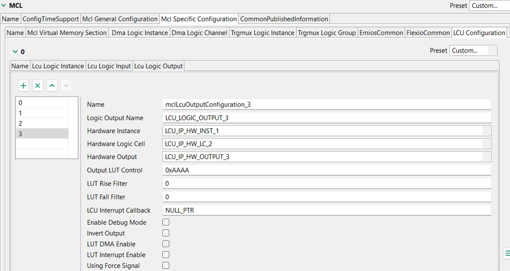

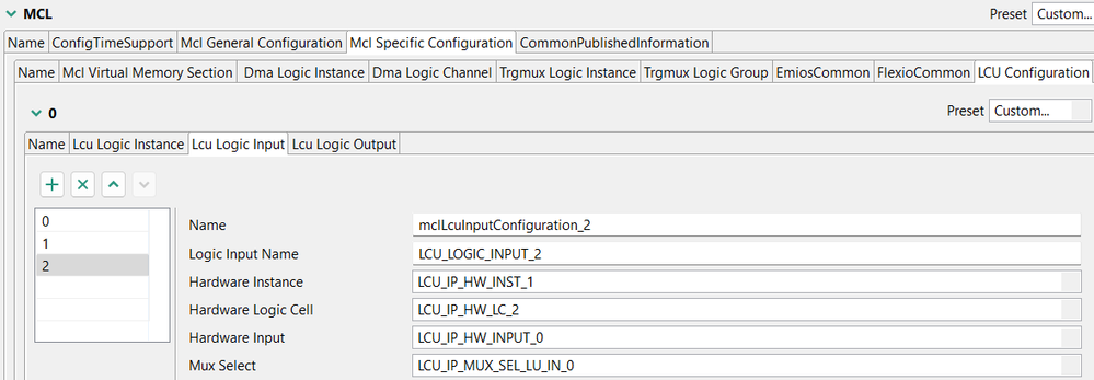

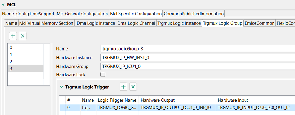

Once again to use another pin to output the signal from PTA3 to PTC10 there are only two options, one is presented above by using PTC10 as emios_0_ch6 and the other solution is to use PTC10 as lcu1_out11:
Then you need to route the signal from PTA3 (lcu0_out2) to PTC10 (lcu1_out11) using TRGMUX:
Then we need to update the LCU configuration for the new input:
And then we update the LCU output config:

and the last step is to update the model with the new LCU output:

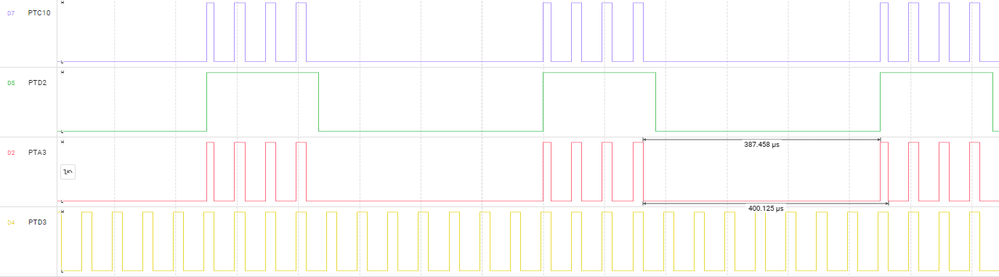

Then rebuild and flash the project on the S32K312 board, and check the pins with logic analyzer:
