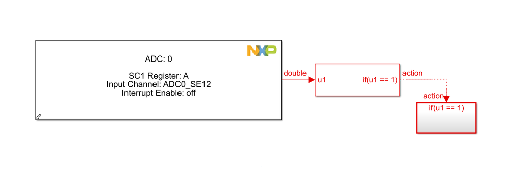

So top level looks like this:

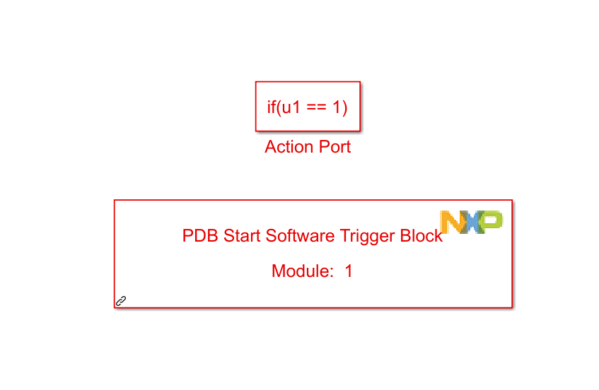

Inside action block is this:
ADC0 triggers the start of PDB1 which controls ADC1.  I didn't try to run this, I just threw the blocks together for visual reference.
It seems more complex than it needs to be though.  If you're already reading the CAN bus with ADC0 why not just use those values?  Why the timing needs?  You could start a timer anytime the ADC reads a high signal if you need timing.  That would allow you to read both the high and low simultaneously.  Also, why do you need to read both?  Can't you just read one and assume the other is an inverted mirror of it?  The reason Razvan asked what the task was is so that he could solve the correct problem.  Solving the problem you have right now may turn out to be a dead end and a waste of time.  There may be a better problem to solve.
