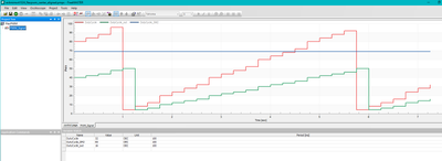

I still cannot reproduce the error. The example is also working on MATLAB R2021b on my side, as shown below.
What revision of the IMXRT1024 evaluation kit are you using? Also, did you use the OpenSDA to download the application on the board? Could you please be more specific about the error that you encounter? Does Simulink throw any error when building the model? Is the download process successful?

I cannot see a graph like you are showing above. the values are always zero on the duty cycle.
The model was successfully build and loaded to the board and I reset the board successfully.
