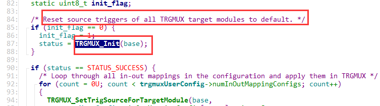

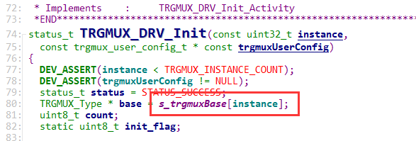

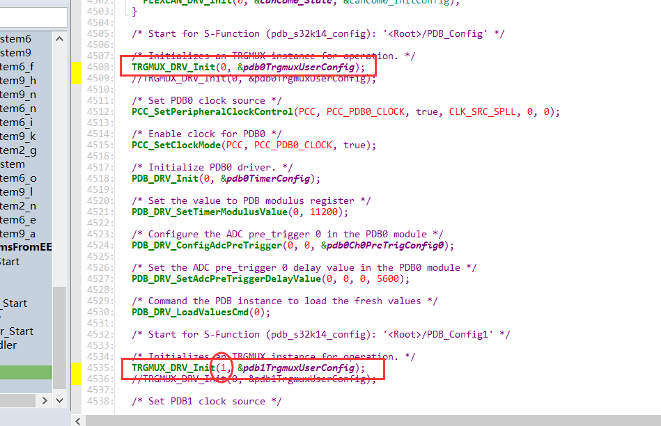

PDB0 TRUMUX is invalid when PDB1 TRUMUX is initialized。

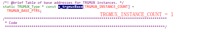

Hi xmwang‌,
Thank you for pointing out this error we had in such a detailed way. You are correct, there is only one instance of TRGMUX - instance0.
We opened a bug internally (AST-904) and we'll put the fix on the hotfixes page soon.
