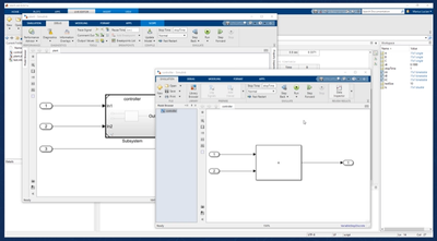

I follow the video from MATHWORK (Link) to create a simple PIL test with NXP_Support_package_S32K3xx version 1.5.0 on MATLAB 2024a, and the working EVB is RD-K358BMU. The attachment zip file is my implement.
After I create the SIMULINK code, I modified the configuration (both plant and controller), including selecting MCU, modifying UART, MCU, Platform in NXP configuration tool, and modify PIL management, and them run.
Seem the compiler run success with some warning code, but the serial port can not connect so that there are some error message as image (I already checked that my COM number is correct).

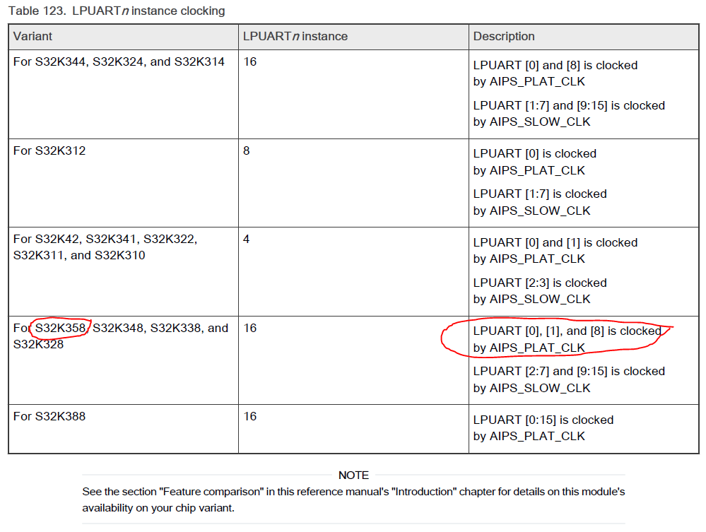

The LPUART1 used by the Debug port on the RD-K358BMU board, uses a different clock source than the other instances of LPUART. This is mentioned in Table 123 in the S32K3xx Reference Manual, Rev. 8, 01/2024, as you may see below:

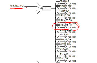

Now, inside the S32CT, under the Clocks Diagram, you can see that in the MBDT for S32K3 1.5.0, which uses the RTD 4.0.0, the LPUART1_CLOCK is correctly represented, as being driven from the AIPS_PLAT_CLK which runs as 120MHz in this case.

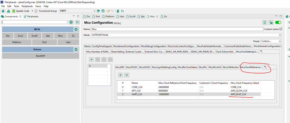

But the Clocks configuration components, translates settings into the Mcu Component of MCAL in S32CT. But, in the Mcu component, under McuModuleConfiguraiton -> McuClock SettingsConfig->McuClockReferencePoint, the actual value for the UART reference point was set to the reference the AIPS_SLOW_CLOCK which is 60MHz. This value, is used inside the Uart component under the Uart Clock Reference, which provides a wrong value to the Uart driver, and this is why, you were not able to communicate over Serial in PIL mode. In other words, the LPUART was configured to work at 120MHz by the Clock tool, but when the baudrate was computed, the configuration was using actually the 60MHz value instead of 120Mhz.
So in your example, what you have to do is to open the external configuration tools, go to Mcu->McuModuleConfiguraiton -> McuClock SettingsConfig->McuClockReferencePoint and change the reference for the UART_CLK to AIPS_PLAT_CLK.

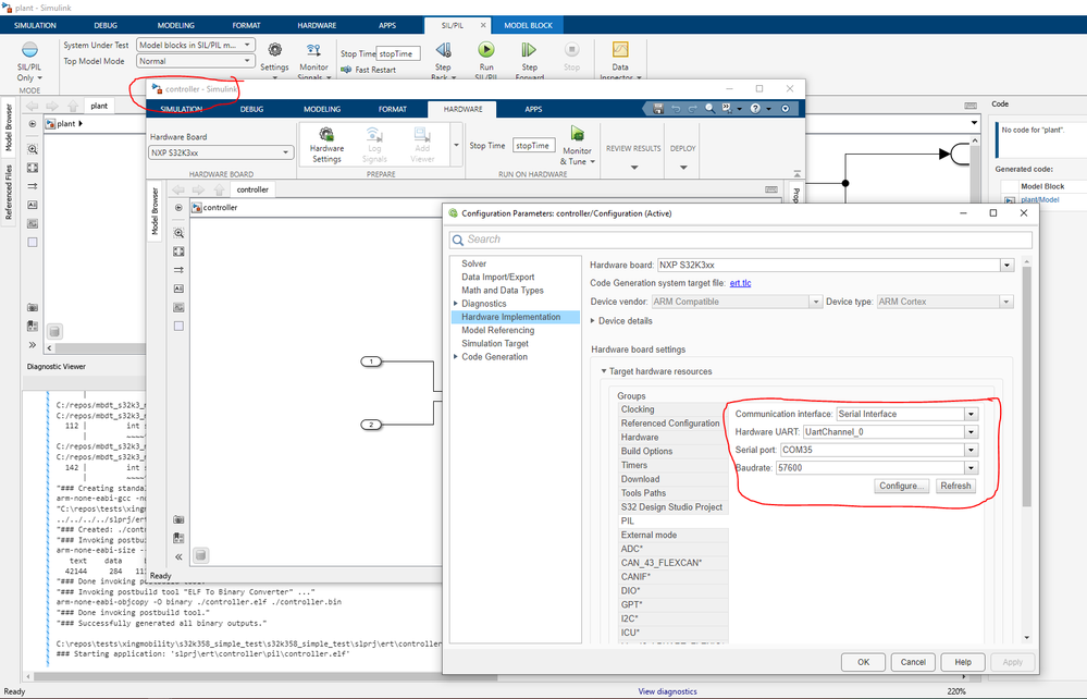

Then make sure that you do these changes for both controller and plant, and you select the right baud rate both in pland and controller Simulink Settings, like in the image below, of course with respect to the actual COM port.
Additional comments regarding your project:
1. When you run PIL, both plant and controller needs to have the exactly same settings when it comes to Simulink Settings and Hardware Target configuration. Because of that, I strongly encourage you to use referenced configurations, which will solved this requirement for you, because the Simulink settings will point to the same configuraiton reference.
