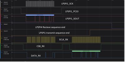

I am trying to communicate with a IsoSPI transciever using two SPI modules - LPSPI4 as master and LPSPI1 as slave. The master manages to send the data and the device responds by sending data to the slave, yet after saving the read data to a variable the variable seems to be empty (equal to 0). I tried to make an example project without the transciever, just between a S32K344 and S32K144 boards and everything seems to work well, I could see all the data transfered in FreeMaster, but when it comes to communicating with the isoSPI transciever, all of the data variables in FreeMaster are equal to 0x00 without any change through time. I am attaching the project and the configuration since I am unable to find the reason why the read variable is empty when tested on the communication with another device. As mentioned before, the device sends a 48 bit response, the s32k344 evb does not manage to write it to the variable..

LPSPI1 is set as Master and LPSPI4 is set as Slave.
The baudrate for both LPSPI peripherals is set to 2MHz.
The master send command works well and the BCC device is able to read the data and send a reply. The problem I've encoutered is with the Slave recieve command, it seems that either the timing of the recieve command is bad or maybe I've missed something while setting up the slave based on the example I was doing from the previous post.
Recently I've tried running the slave recieve block during a hardware interrupt which is triggered after the master send transmission ends. I've added a Led enable block to debug the interrupt.
From the logic analysis it seems that the transmit sequence ends in the middle of the recieve sequence, thus LSPSPI4 cannot recieve the whole message. Though I am not entirely sure about that. From the SPI_GetSequenceResult block for LPSPI1 recieve the result is written as 2 which means that the sequence ended in failure.
