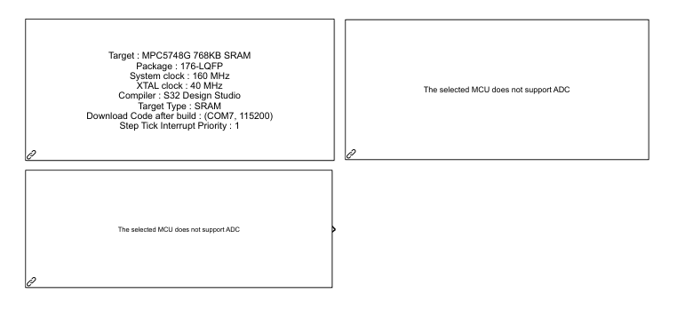

I have been trying the follow along with the video series for BLDC Motor Control with MBDT Training course and the devkit I had purchased from NXP was not of the same type as the training course.  So, I have been following the examples along until I need to change PN of my application.  In starting with the ADC programming tutorial number 4, I changed the Target type to my target board (an MPC5748G).  When I do this, the ADC config and the ADC start blocks appear to say that ADC is unsupported by the MCU.  This does not seem to be correct.  This is also happening when I launch Simulink examples and switch the Target to my MPC5748G.  Based on manual excerpt, I have quite a bit of ADC available to me...  Please help...

Hello zcampbell@amshowa.com‌,
Unfortunately the message is right. The MBDT toolbox does not currently support the ADC conversions on MPC5748G. The MPC5744P is more suitable for motor control applications.
Hope this helps,
Marius
