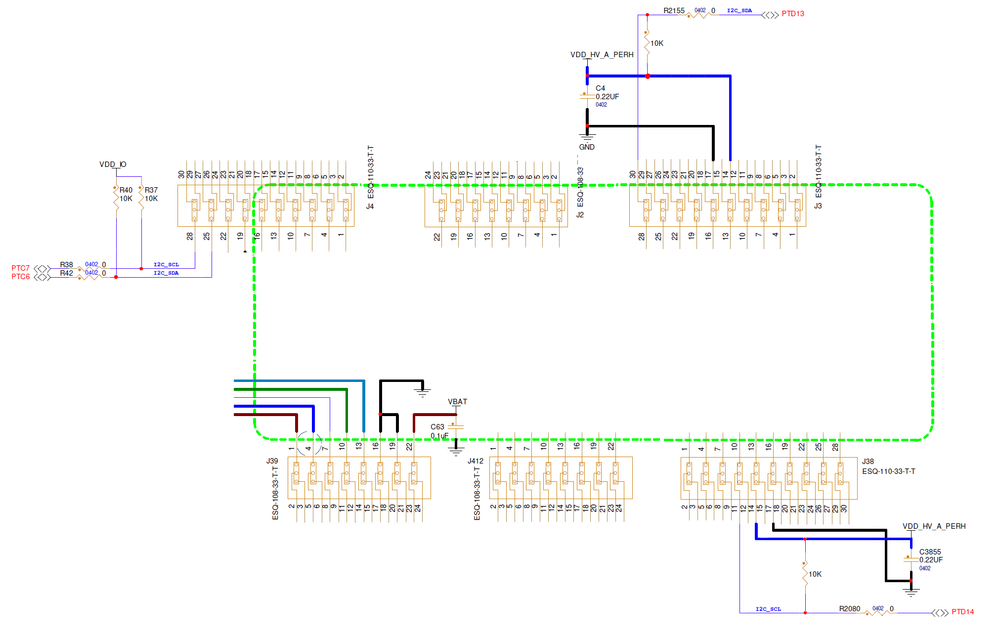

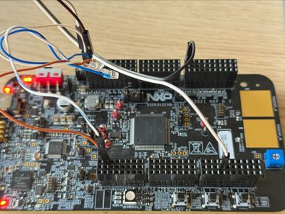

Can you provide a picture of your setup with the S32K312EVB-Q172 and the connections?
Just to be sure, have you connected the Pull-up resistors for pins PTD14 and PTD13 as in the picture below?

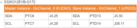

In the case of the s32k3xx_i2c_async_s32ct example, the table below describes the connections between the I2C instances on S32K312-Q172:
But in that help file, there is also a Note below that reads:
  • Note: When running this model on S32K311EVB-Q100S32K312EVB-Q172 or S32K388EVB-Q289, please note that the signal lines used for the I2C transmission require external 2k Ohm pull-up resistors between SDA and VDD and SCL and VDD. For VDD, you can use the pin J40.9 for S32K311EVB-Q100, J39.13 for S32K312EVB-Q172 or J696.14 for S32K388EVB-Q289.
Because the other I2C Instance has pins PTD13, PTD14 with no pull-up resistors, you need to add those, and connect them, one example is in the picture below:
I have created a simplified version of the schematic showing only the I2C connections needed with pull-up resistors:

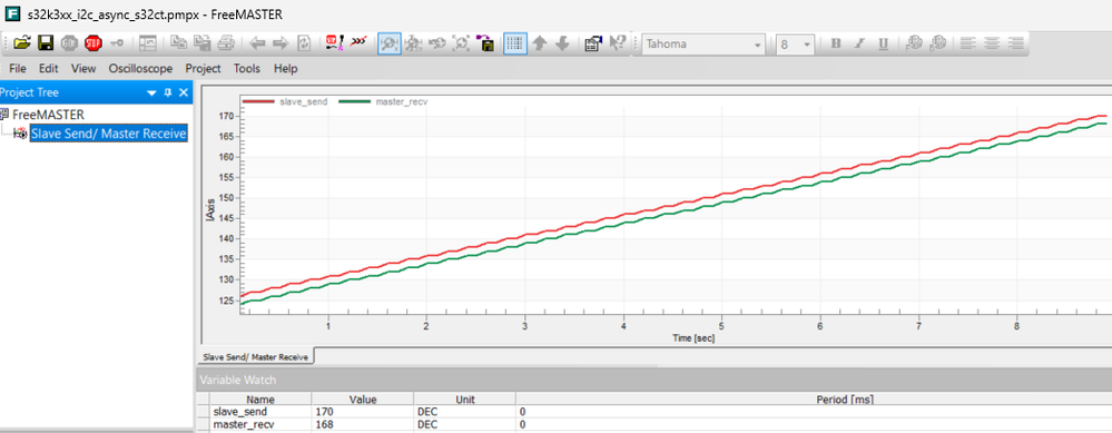

After you make all the connections , then you can open FreeMASTER and take a look at variables:
Both of them will increment accordingly and go up to 256 then roll back to 0.

I did make changes as suggested, on FreeMASTER i only see Slave_send as 0 and master_recv as 255. I do not see any ramp up or incrementing of values. Are there any other set of pins that can be chosen as the slave I2C Instance instead of PTD13, PTD14?
