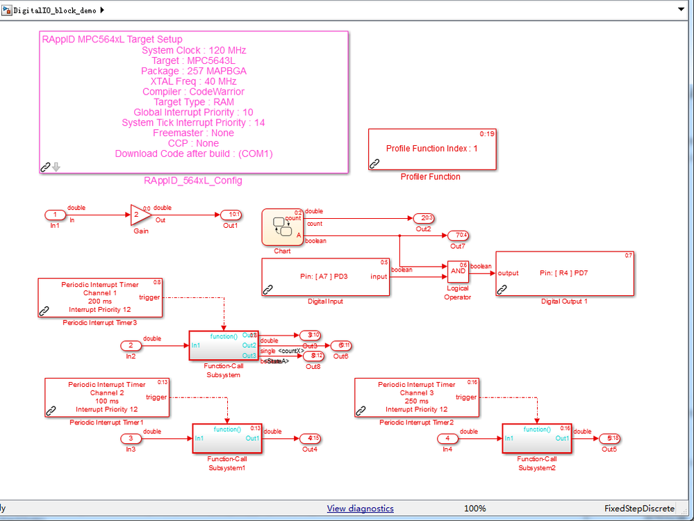

Hi everyone,
  While I build the DigitalIO_block_demo,an error occur.

D:\matlab_work>"C:\MCToolbox\rappid564xl\tools\BootLoader\RAppID_BL.exe" "C:\MCToolbox\rappid564xl\tools\BootLoader\\" "D:\matlab_work\DigitalIO_block_demo_rappid_rtw\DigitalIO_block_demo.rbl"
An unhandled exception occurred: System.ArgumentOutOfRangeException: Index was out of range. Must be non-negative and less than the size of the collection.
Parameter name: startIndex
In System.ParseNumbers.StringToInt(String s, Int32 radix, Int32 flags, Int32* currPos)
In System.Convert.ToInt32(String value, Int32 fromBase)
In RAppID_BL.GUI_Driver.GetCommChannel()
In RAppID_BL.GUI_Driver.StartBTL(String homeDir, Boolean showProgBar)
In RAppID_BL.MainProgram.Main(String[] args)
Build process completed successfully

Hi Hongjin,
   Please check that you have some device connected to COM1 or other COM, if you don't have any device connected please remove the download option. This is issue is already logged  and in process to be fixed by the Bootloader team.
Radu
