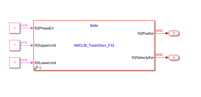

Dear Community,
I am trying to load the MBDT EQADC example for MPC577xc to my board (MPC5775E). This works fine and it tells me that the configuration of the toolchain should be OK.
Anyways, as soon as I add AMCLIB components (e.g. ATO, see picture below), which I need for processing the data, I get an error during the build process.
Please find attached the full diagnostic report. In addition, I summarized the main findings below:
"Warning: File 'codedescriptor.dmr' not found"
"error: insn does not satisfy its constraints"
"internal compiler error: in copyprop_hardreg_forward_1, at regcprop.c"
"Build procedure for Resolver_eqadc_mpc577xcTest aborted due to an error"
"Failed Code generation information file does not exist."
Is there anything wrong with my AMCLIB setup? Has anybody had a similar issue before? Looking forward to your response/help.
