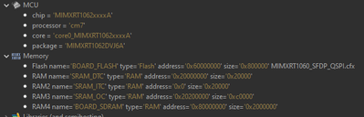

I'm using a custom board with the MIMXRT1062DVJ6B chip.
What needs to be considered in Simulink / MBDT, so that code generated from Simulink can be flashed directly to the device?
Or that axf / bin / hex / s19 can be flashed to the device using MCUXpresso / MCUXpresso Secure Provisioning / MCUBootUtility?
The board has the external flash "W25Q64JVSSIQ" from Winbond.
What do I need to change and what else needs to be considered?

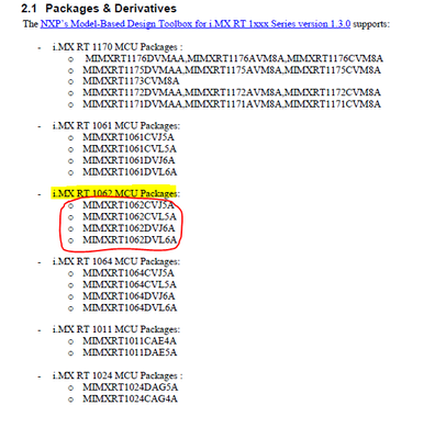

Unfortunately, the IMXRT 1062 part that you are using (MIMXRT1062DVJ6B) is not supported in the latest release of MBDT for IMXRT Platform (see the attached image from Release Notes). But since I did not notice any major difference between MIMXRT1062DVJ6A and MIMXRT1062DVJ6B, you could try to select the MIMXRT1062DVJ6A hardware part from your Simulink model hardware parameters and build it. We cannot guarantee that the generated axf file will work, hence the specifications from Release Notes.
Basically, the generated axf file can be deployed using MCUXpresso. If your custom board has an OpenSDA, you can deploy automatically the axf file from Simulink, choosing the OpenSDA download method from the Hardware settings of your model.
Hope this helps you!
Let me know if you could manage to deploy the axf file generated from Simulink to your custom board!
