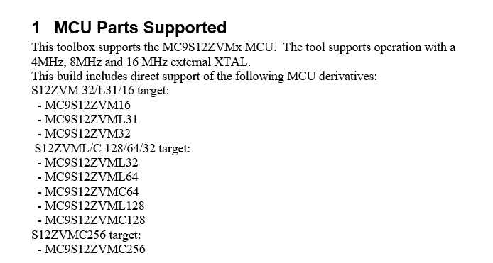

constantinrazva
Hello m.benderradji@outlook.fr‌,
S12 Toolbox supports the following parts (as stated in the release notes)
So the toolbox does not support S12ZVMB unfortunately (not tested on). I do not know what are the differences between them. If they are very similar, the toolbox could be ported.

adriantudor
Hello @SUT ,
The answer given by Razvan is still up to date. Anyway, the S12ZVMBEVB development board was designed to drive DC two-phase motor using H-bridge, while the MBDT for S12ZVM has only BLDC/PMSM examples.
