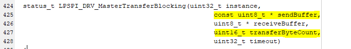

The signature of the function LPSPI_DRV_MasterTransferBlocking requires that the data shall be transferred as an UINT8 array. So, if you want to send an UIN32_T value, you shall first cast that to an uint8_t * data type. The Simulink block expects such value data type and will compute automatically the size of the input array.
In this way, you could also send multiple bytes as a single transfer, in a combination with the Continous Transfer setting of the SPI_Config block.
If the transfer is not working, then the priorities of the interrupts shall be considered. When the timeout of the transfer action is computed, it uses the OSIF software component, which uses the PIT channel 3 as a timer for such computation. So the priorities of the PIT 3 > SPI > Step timer.

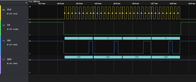

This was tested by first sending an array of 1 UINT8 (using a 1 input mux) with a frame size of 8 bits.  This compiles and executes correctly.
I then switched to a frame size of 32 bits, and expanded the mux from 1 to 4 inputs.  Simulink reports the output of the mux which is feeding the spi block to be "uint8 (4)", however the generated code with this configuration does not issue a byte count of 4, it issues a byte count of 1.
Additionally at the time I had the baud rate set to 10,000bps.  When I manually changes the transfer size to 4 bytes, the compiled code executed without any issues.  The actual transfer would take (setup time + 3.2ms); the SPI transfer timeout should be 50mS, and the step timer is 100mS.

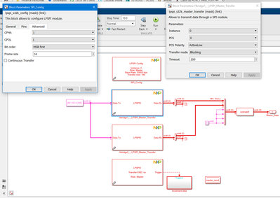

10,656 次查看
gmud1234
I had/have a similar problem with data length set to 2 bytes (16 bits).
If I provide it with uint8[2], it calculates the length by dividing [2]/2 = 1, and sends nothing.
If I provide it with uint8[4], it calculates the length by dividing [4]/2 = 2,, it sends the first 2 bytes and ignores the second 2 bytes.

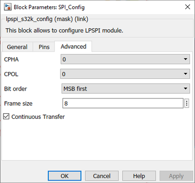

ruihang_wu
Have you tried setting the frame size to 8b in the SPI config block and sending a uint8[4] to the SPI transfer block? And of course with continuous transfer checked
10,510 次查看
gmud1234
If you set it to 8bits, it drops chip select after each transfer of 8bits. This does not work if the peripheral is expecting 16bit before dropping chip select.
10,486 次查看

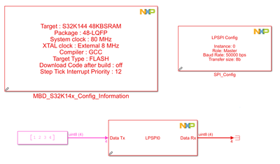

ruihang_wu
I tried with 8b frame size and continuous transfer checked and it seems to work fine. I didn't connect the bus to anything so there is no reply.
This is running on the S32K144 EVB. But I have been running it on a proprietary board with the same MCU with these settings.
I attached the simple model if you want to compare the SPI settings.
