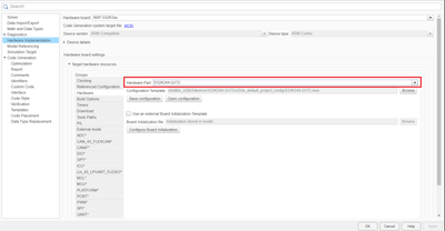

1. Open the model you would like to test, or create a new model, and select the S32K344-Q172 processor from the Model Settings (found in the MODELING tab of your Simulink model), under the Hardware Part option:
This will associate to the model the default configuration project we deliver for S32K344-Q172.
2. This configuration can be customized according to your hardware particularities, saved under a different name, and reused across multiple models developed using MBDT for S32K3. Chapter 3.7 (Support for custom default project) inside the Model_Based_Design_Toolbox_S32K3xx_Series_Release_Notes document provides more details on how this can be achieved.
