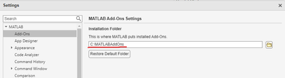

2. Try uninstalling and installing the toolbox in a shorter path with no spaces and then try again. You can do that by adjusting first the MATLAB Add-Ons Settings under the Intallation Folder in Settings -> MATLAB -> Add-Ons.
-> i modified the add o path in C:\Users\stefp\AppData\Roaming\MathWorks\MATLAB_Add-Ons\Toolboxes\NXP_MBDToolbox_S32K1xx
still the same error but now the toolchain used is "MinGW64 | gmake (64-bit Windows)" i do not have the option for S32DS GCC anymore
