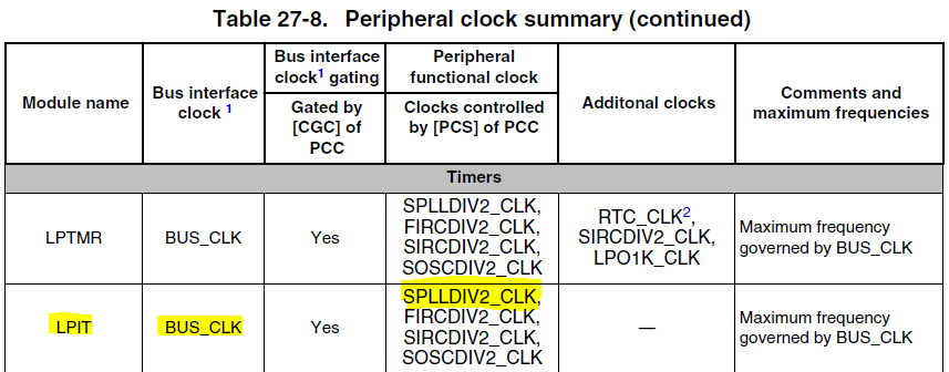

When it comes to LPIT clocking, it uses as a source the SPLL (system PLL) - notably the SPLL div2. If you were to track the clocking schema we use (the default clocking you get in our toolbox - although you can use a custom clocking setup that you can generate using Processor Expert from the S32 Design Studio), the SPLL is set to 80MHz, so the LPIT will have it's clock source set to 40MHz (the functional clock). The module clock will be the BUS clock, also set at 40MHz. Having this in mind, you can get to LPIT events being triggered much faster than you can probably use (being periodically generated, you should execute code in between 2 such even triggers - if this window is very narrow, you can't run so many instructions); so you can't get to 25ns interrupt generation. You have to keep in mind that first of all you need some time for context switching (state saving code / state restoring code that is ran in the ISR epilogue / prologue). If that is not the only interrupt running, you should account for others as well. Furthermore, you should profile the code that is ran inside the ISR to get the minimum size of the window between 2 such interrupts - but make sure to use a value that is higher than this if you are also using other interrupts in your application.
