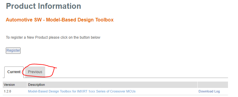

For previous version, How can I get a license for using that one?
If you want to use the previous release, you have to go to our download page, select the Preivious Tab, and find the Motor Control Toolbox for MATLAB/Simulink MBD for Kinetis V series. But keep in mind that we will only provide support for our current release!
