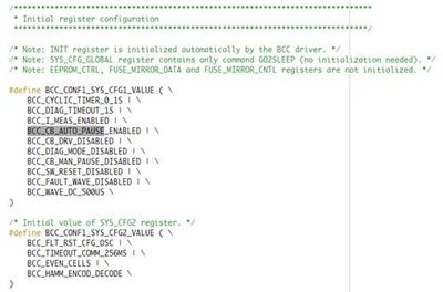

Last but not least, I would like to explain a bit how to change the initial configuration that is sent during the initialization to the BCC. This configuration enables the  CB_AUTO_PAUSE bit of the MC33771B. Even if this default configuration is not visible in the BCC Config block, you can change it to the one that suits your application. For that, you have to edit the file bcc_initial_configuration.h available on the  mbdtbx_s32k\src\BCC_SDK_SW\SDK_SW_Driver\bcc_s32k location. This file is copied every time you press the code generation button so you need to change it only once. (Please backup this file first!). If you want to disable the CB_AUTO_PAUSE, simply replace it with BCC_CB_AUTO_PAUSE_DISABLED.

For pausing the balancing switches when a measurement is performed, there is a second option: CB_AUTO_PAUSE. This will automatically pause the balancing switches when a measurement is performed. This option is already enabled in the MBDT configuration.
