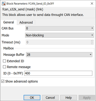

Is there a way to have CAN_ID as an input to the CAN send block rather than a fixed value?

Instead of having a fixed value in the CAN send block
Can I somehow have CAN ID as an input alongside data and length?
The reason is I want to send messages on a different ID depending on a bitmask value (1-16) and if I could enter the ID instead, otherwise I have to make 16 versions of all my CAN outputs.

Hi @Poley and @Maciek ,
I attached a cumulative patch, a self-extracting archive, that contains this improvement and the previous patches from CAN FD in S32k14x EVB .
The steps to apply the patch:
1. Download the attached zip file and unzip it.
2. Run mbd_find_s32k_root() to get the root folder there the S32K toolbox is installed.
3. Close Matlab.
4. Open the MBDToolbox_S32K1xx_4.2.0_id_input_patch_3.exe file and extract it's contents to the root folder of the toolbox.
To show the ID input you have to check the "Show ID input port" option in the FCAN_Send and FCAN_Receive blocks.
Paul

3,353 Views
Poley
Contributor V
Hi @paulvlase
I now get this message when using this patch:
The fix you sent seems to work perfectly I was just wondering if this new message points to an issue I haven't come across yet?

paulvlase
Hi @Poley ,
No, you can't pass the ID as an input signal. To allow you to do that, we will need to update the toolbox.
I can send you a patch tomorrow if you are fine with it, which you will have to apply over the toolbox.
Paul
