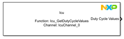

The ICU_DUTY_CYCLE property works with the Icu_GetDutyCycleValues Simulink block. It is returning the a structure that contains ICU Duty cycle parameters. It contains the values needed for calculating duty cycles i.e Period time value and active time value.
- Active Time: this represents the duration during which the signal is in its "active" state (usually the high state for a digital signal). It is the time the signal remains at a high level during one cycle.
- Period Time: this represents the total duration of one complete cycle of the signal, which includes both the active time and the inactive time (low state). It is the time from the start of one high state to the start of the next high state.

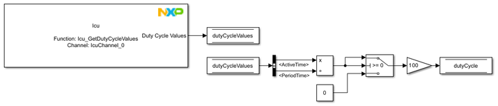

Based on the above information, you will find the following approach in the model example.
Based on the dutyCycleValues, represented by a bus signal, you can calculate the dutyCycle percentage of your generated PWM signal.

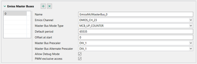

Hello, @dragostoma
I have done my calculations, Where
Core CLK = 160000000, Master Bus Default Period = 65535,
Emios Common CLK divider = 1 & Master Bus Prescaler =1 .
then Calculated Frequency = 2441 Hz & Period = 0.4 ms .
So when I feed an input PWM of 100Hz & 50% Duty, get active time = 24915 & period = 27171(Image is in prev post) which is not correct. So what can I do.
