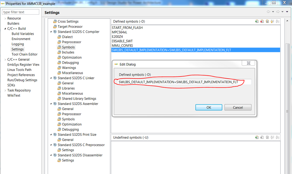

Regarding the old IDE (which i honestly don't know how to use it) i seems like you need to add a define like this
SWLIBS_DEFAULT_IMPLEMENTATION=SWLIBS_DEFAULT_IMPLEMENTATION_FLT
This is how you do it in S32DS but i do not find a way to add in CW IDE.
