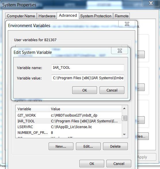

Ok, you installed the IAR in C drive but you still have spaces in the your paths. In case you do not want to modify the 8dot3 option in your Windows OS then you should avoid installing programs in default folder "Program Files".
Anyhow, my settings for Configuration Parameters are identical as yours.
In addition, here is my settings for the IAR_TOOL system variable. As you can see on my case works fine even in paths that contains spaces
In my case if i run the command FSUTIL.EXE 8dot3name query C: into the cmd terminal i get:
Please run the same on your side and let us know the result.

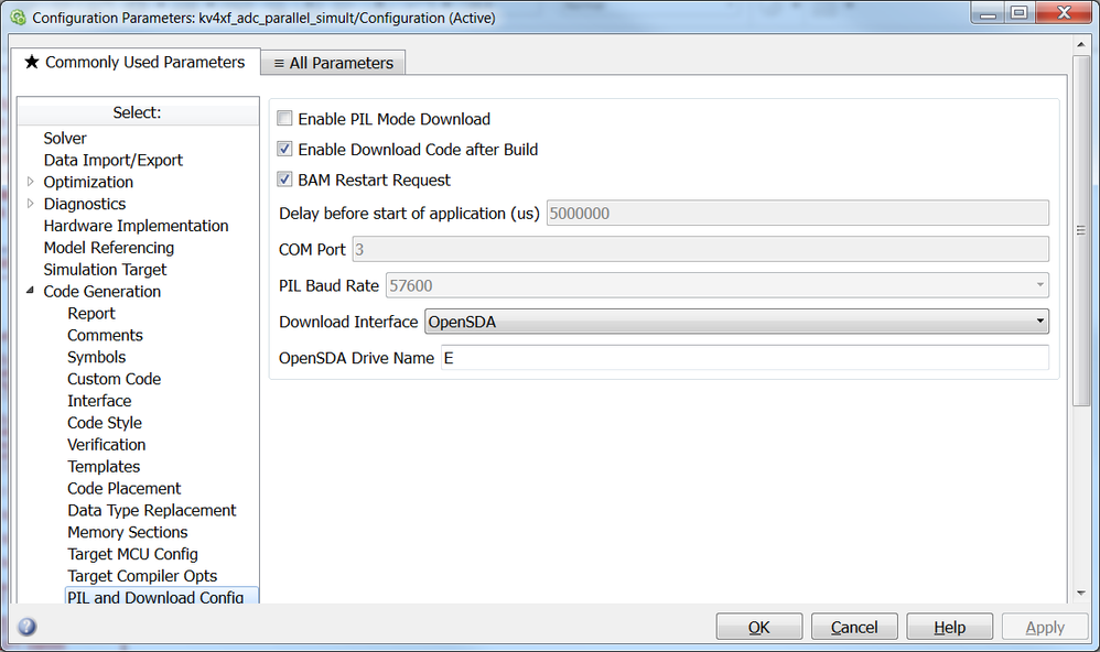

But as my screenshot shows, I did not download the program to the board, my question is if the Download interface selected OpenSDA, is not there no need to use the RappID BootLoader to guide the program to download it to the evaluation board. I still do not know if the .mot file can be dragged directly into the HVP-KV46F15 (G).
I also tried to leverage the RappID BootLoader but did not succeed either, "Loss Communication with CCP MCU. Please cycle power and try again." How can I solve the problem in your experience? Thanks for your help.

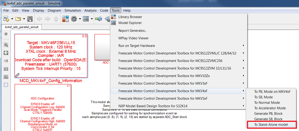

I did a little bit of digging and i was able to make your model (the one that you have attached here: https://community.nxp.com/servlet/JiveServlet/download/967567-1-412987/kv4xf_adc_parallel_simult.mdl... ) to generate the code correctly.
Here is what i've changed (in case someone else might be interested)

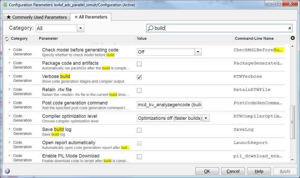

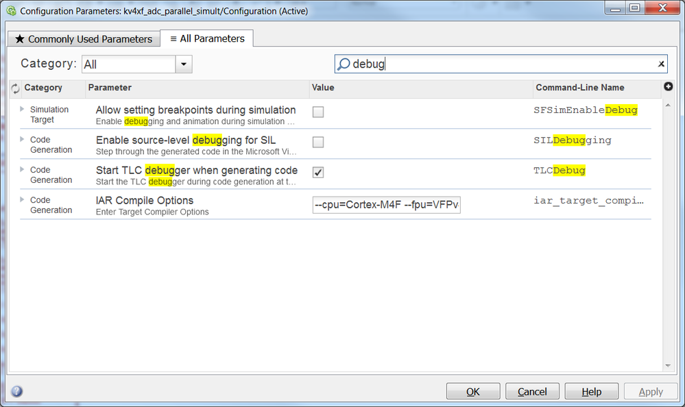

#1: disabled the Code Generation: Start TLC debugger when generation Code. That option should be unchecked otherwise the code generation will stop.
#2. Enabled the Verbose Build option to see the output of the code generation in the Simulink build console
#3 Disabled the "Enable PIL Mode Download" option - since you wish to generate the code and download it to the target for the real peripherals
#4: Covert the model back to "Stand Alone model" to make it compile with cross compiler toolchain for the CPU and Board you have selected
Now, after all these 4 modifications you should be able to see the *.elf and *.mot file generated.

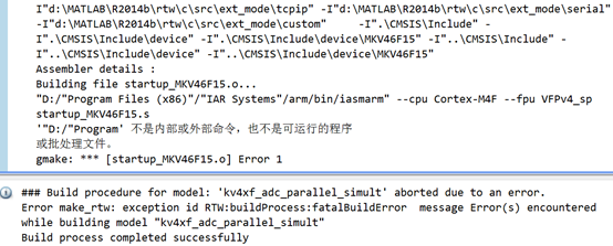

Now, in respect with your issue of not being able to build the code successfully i think it is related with the paths on your PC
As i can see from your screenshot, it looks like the "Program Files" folder is NOT RECOGNIZED - and the make file looks for a folder that does not exists: "D:/Program"
I think you are in the same situation as the one described here:  Something wrong happens when starting SIL or PIL simulation
Please try to apply the same workaround (https://community.nxp.com/thread/451367#comment-906759) - or at least avoid paths that contains spaces.

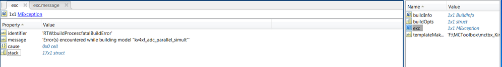

I looked over your zip file with the generated code. According with the MATLAB report you have a build error. The model was not compiled successfully.
Therefore, this is why you do not see the *.elf or *.mot files in the generated folder.
Please add here the Simulink Build Console report - perhaps we can figure out that is the cause of the build failure.
