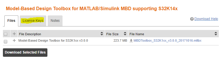

Hello 81387389@qq.com‌,
The previous version is still available here. For this you need to be logged in.
If the link is not working just go to the NXP Software & Support > Product List > NXP Software > Model-Based Design Toolbox and under Previous you will find the tool that you are looking for.
The licensing process is the same as for the 4.0.0 version.
Hope this helps,
Marius

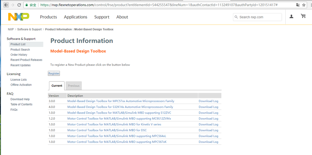

81387389
Thank you Marius, however, the Previous button on my browser is gray, and unclickable.
That means, when I click the Previous button, there was not response from website, and the page was still on Current.
May be there are some difference of operation environment or account, location..., do you have any suggestion? Thank you in advance.
1,374 Views
constantinrazva
Can you try from a different browser? I've tried with a non-NXP account, and Previous is clickable. I've tried with Google Chrome and Internet Explorer. If that does not work, you can try from Private mode in Chrome, or you can first try to logout, delete cookies, login again. If this does not work, please open a ticket for technical support here (go to 'Go to Ticket').
Hope this helps,
Razvan.
