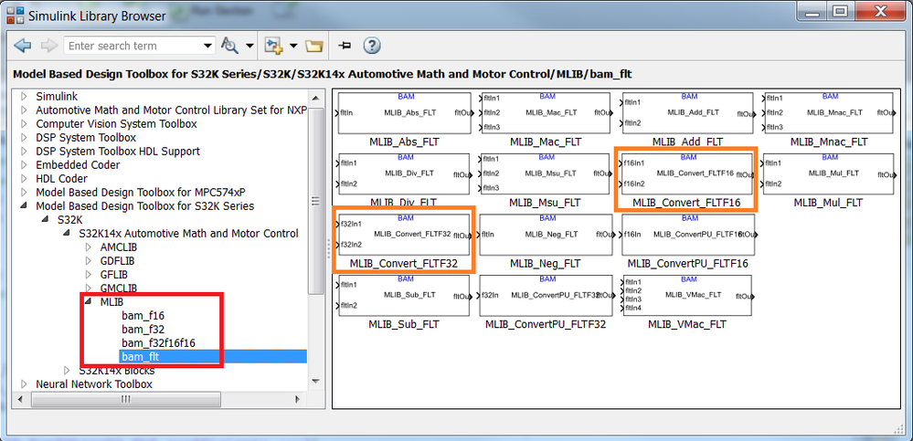

The AMMCLIB provides a specific blocks to convert between various data type formats. These block are available within the MLIB subset.

Using these blocks, I've started to do some investigations.
First I've build a simple model to check verify the conversion results and the generated code. The scope of this test is to see if we can get rid of the fmod() function usage while preserving a good conversion precision.

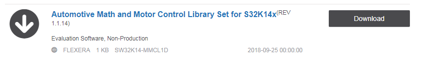

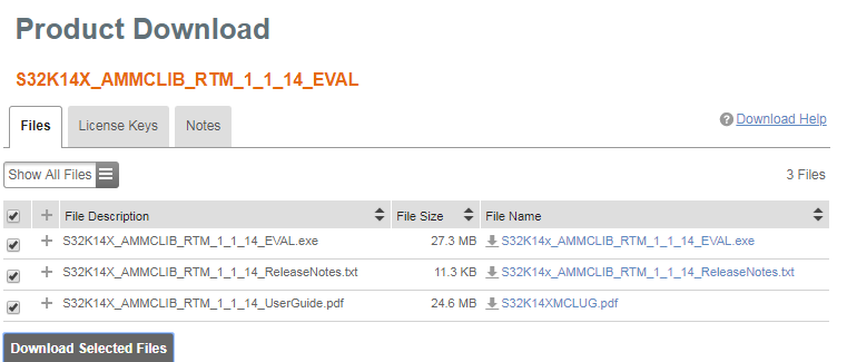

As you mention, following the link you provided in your post: Automotive Math and Motor Control Library Set|NXP
gets you to the AMMCLIB site, and going to the downloads page you can download the libraries but more important the User's Manual.
The User's Guide SK32K14XMCLUG.pdf is a great resource (I'm not sure if I'm allowed to attach it here, that's why I pointed out how to get it), specially because each function contains the Declaration, Arguments, Implementation details and Code Example in C.
