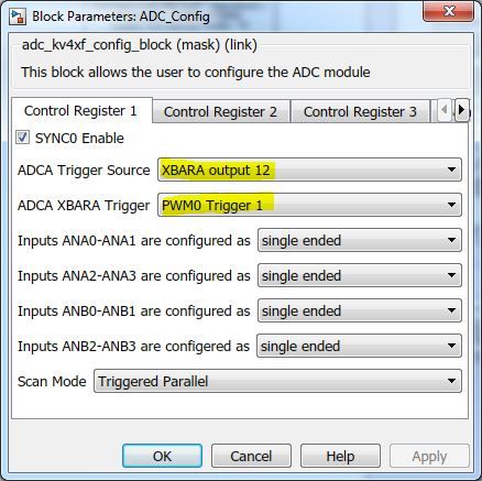

In the Reference Manual I found this:
This is why I configure this in the ADC Config Block:

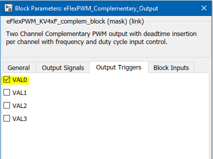

In the PWM Block different values are available.
In center alaigned type these are:
So I configure the following in the PWM Block:
So in the Reference Manual I found this:
--> In my opinion the yellow marked numbers in the picture above are the VAL0, VAL1, VAL2 and VAL3 which you can choose in the PWM Block, correct so far ?
--> The second number marked in the picture above should be the TRIG0 or TRIG1 ?
Because I activate VAL0 I would ecpect the connection to XBARA_IN21. (second line in the picture above: PWM0_OUT_TRIG01)
But XBARA_IN21 has PWMA0_TRIG1 as assigned output.
So why I have to configure PWMA0_Trigger 0 in the ADC Config Block as ADCA XBARA Trigger ?

mariuslucianand
Hello lethuer2‌,
In order to use VAL0 as Output Trigger you need to select in the ADC_Config  for "ADCA XBARA Trigger" the value "PWM0 Trigger 0" (in the first image of the previous answer).
Hope this helps,
Marius
