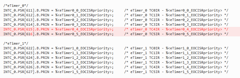

markusransberge
HotFix_5: Correct code generation file for missing/wrong eTimer_0 priorities.
NXP Tracking number: AST-780
Problem: The line for channel 5 is missing in the generated "intc_init.c" file. This also causes that the ISR priority of eTimer_0 channel 4 gets wrongly set.
Root Cause: mbdtargetmainlibpnt.tlc is missing one line of code for the eTimer_0 channel 5 priority.
Workaround: Update the file attached in the following folder (make a back-up copy of the original file before you begin):
Copy & replace mbdtargetmainlibpnt.tlc file into {Toolbox install dir}\mbdtbx_MPC574xP\mbdtbx_pnt\mbdtbx_pnt\

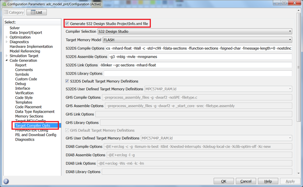

Daniel_Popa
HotFix_4: Add support for exporting generated code as project for S32 Design Studio for Power v1.2 .
NXP Tracking number: AST-300
RequestMDBT_MPC57xxP should enable S32DS project creation from the Simulink generated code
Update Patch:  Update the files attached in the following folders (make a back-up copy of the original files before you begin):
#1: Copy & replace mbd_pnt_make_rtw.m file into {Toolbox install dir}\mbdtbx_MPC574xP\mbdtbx_pnt\mbdtbx_pnt\ folder
#2: Copy & replace mbd_pnt.tcl file into {Toolbox install dir}\mbdtbx_MPC574xP\mbdtbx_pnt\mbdtbx_pnt\ folder
#3: Copy mbd_pnt_ds.p file into {Toolbox install dir}\mbdtbx_MPC574xP\mbdtbx_pnt\mbdtbx_pnt\mscripts\utils\ folder
Open Matlab/Simulink and within the MBD_MPC574xP_Config block you should now see "Generate S32 Design Studio ProjectInfo.xml file" option:
Build the Simulink model to obtain the ProjectInfo.xml file needed to import the automatic generated code into S32 Design Studio for Power v1.2.
