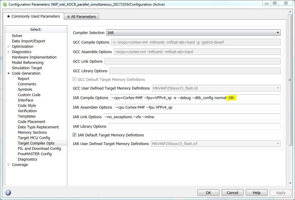

Now, we found another problem caused by the IAR compiler, which reordered some program lines while otimizing the code. We fixed this by changing the optimization -Oh flag with   -Ol or completely removing it. To test this you can change it on the Target Compiler Opts as in figure 4.
Fig. 4 Changing the optimization flag

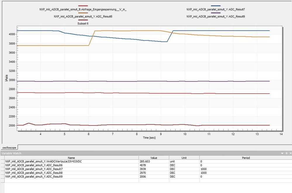

Finally, we were able to read some converted values using Freemaster.
Fig 5. Freemaster reading ADCB values.
Hope that helps!
Hope that helps!
Marius

The Jumper setting is like it is described in the user guide. So I can connect a potentiometer at J2_TxD
The model you have modified runs successfully !
