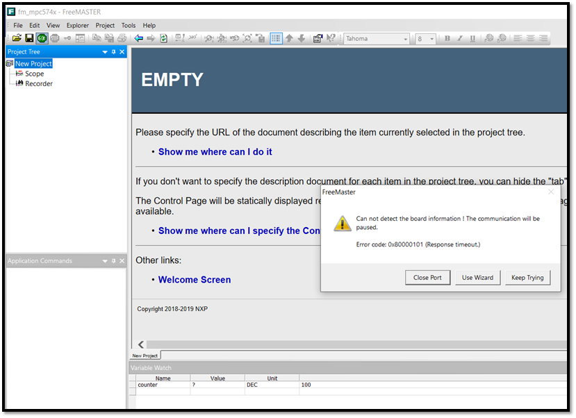

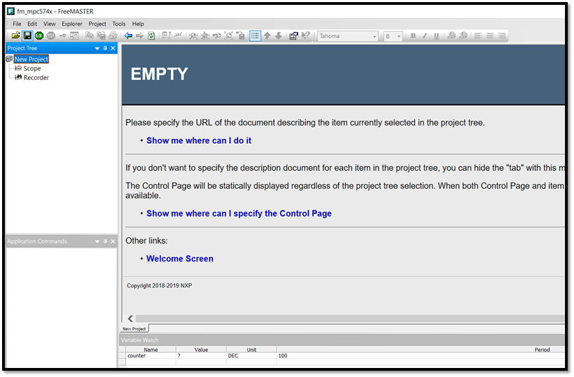

Hi NXP team,
I use hardware "DEVKIT-MPC5744P REV.E.", My Aim to use software Model-Based Design Tools and  Freemaster.
Firstly, I use SOFTWARE INTEGRATION GUIDE (SWIG) document and I run a very simple c-program. It works fine without any problem and RGB LEDs blinks as expected see the attached file blinking the red LED.
After that, I tried to get the first MBD-example using V3-INPUT-GPIO: GPIO Programming.
The Model (see the attached file GPIO_read.slx) is compiled and downloaded on the DEVKIT-MPC5744P Board but unfortunately, there is no reaction on FreeMaster and I got the following error Error code 0x80000101 with the following Massege:

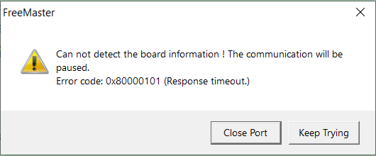

Can not detect the board information ! The communication will be paused. Error code: 0x80000101 (Response timeout)

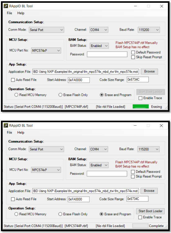

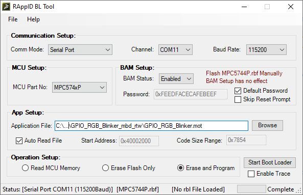

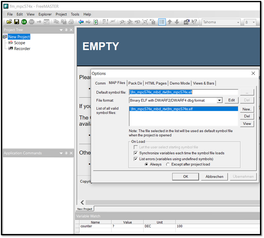

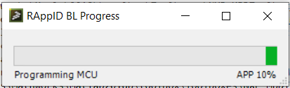

A: I have downloaded the code using the RappId Bootloader, see the pictures. I didn't generate a new code. I just used the application file fm_mpc574x.mot
after that I opened the FreeMaster project but unfortunately no success
B: I tried also using the model. I opend it and generated the code and I got on the diagnostic viewer of Matlab

after that the code is downloaded automatically using RAppID Bootloader
after that I opened a new FreeMaster project but unfortunately no success too

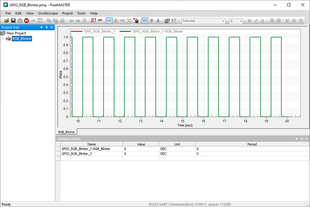

This is the picture with my board. I also tried with the FreeMaster 3.0 and it worked.
Have you tried on another pc? Also, change the cable and the USB port we had similar issues before.

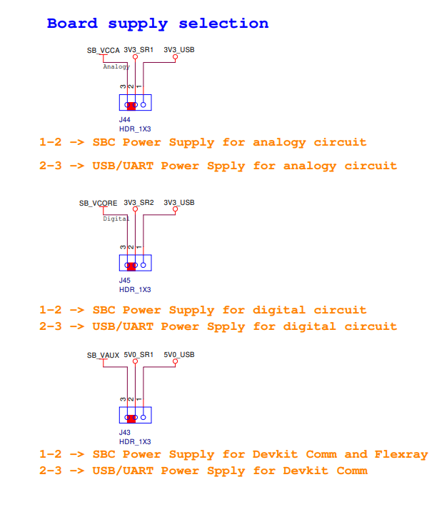

1- If I provide the board with an external power supply, which jumper should be reconfigured?

I attached the link to the schematics. To switch to the external power supply you need to change the J43 J44 J45.

l flashed gpio_mpc574x.mot using RAppID Bootloader, but unfortunately no success.
After that I changed the jumpers 43,44 and 45 to the position 2-3, see the attached pictures. Then I plugged in the external power supply  and flashed again the first attached  c-program "Blinking the red RGB LED" using S32 DS. It worked as expected.
Then I flashed again gpio_mpc574x.mot, also no success.
It is really strange. It turned out that the application file is not flashed into MCU.

1. No, the bootloader seems is not flashing the code correctly. To be sure that the bootloader has been flashed correctly (after reset) please flash using the S32DS other bootloader version, for example the one without RevE. and then flash again using S32DS the right rbf flash. This will erase the old bootloader and will assure us that you are running the bootloader correctly.

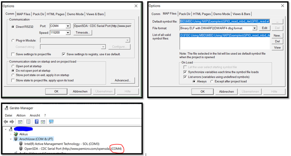

To be sure that the problem is not caused by the USB port, I suggested before, you can try running an UART example communication on the same pins UART1 PB2/PB3, both directions.

Regrading to point 2: I will checkFreeMASTER.
I have attached the GPIO_RGB_Blinker.slx, GPIO_RGB_Blinker.mot, GPIO_RGB_Blinker.map, GPIO_RGB_Blinker.elf and GPIO_RGB_Blinker.pmp (FreeMaster)

I've tested your mot file and FreeMaster project and it works on my RevE board.
Now, for the bootloader please flash the rbf attached, firstly, MPC574xP_S32DS_UART1_CAN0_OpenSDA.rbf and finally MPC574xP_S32DS_UART0_CAN0_OpenSDA_RevE.rbf. This is the right one for the RevE.
Now, you can also try to use the FreeMaster 2.0 instead 3.0. But if you completed the flashing and the led is blinking, then the problem is with the serial connection. Can you try, the freeMaster connection on another PC? You don't need to reprogram the board, just install the FreeMaster and test the connection.

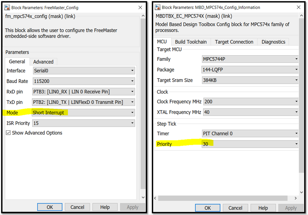

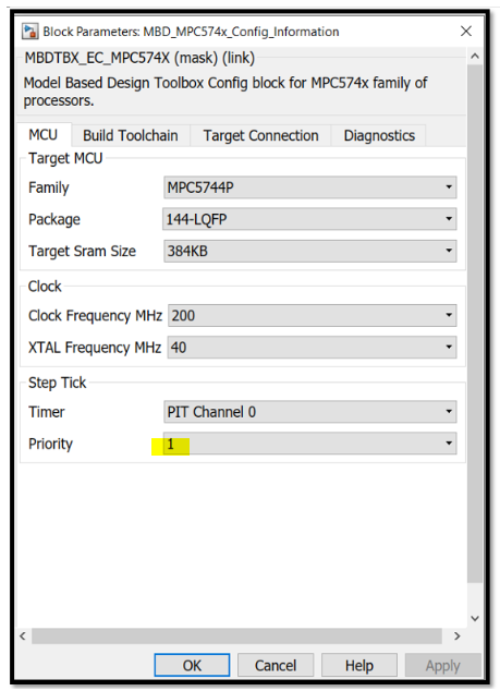

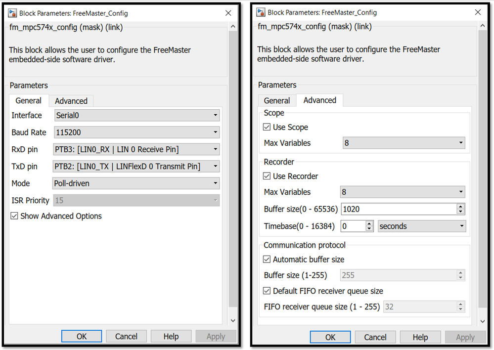

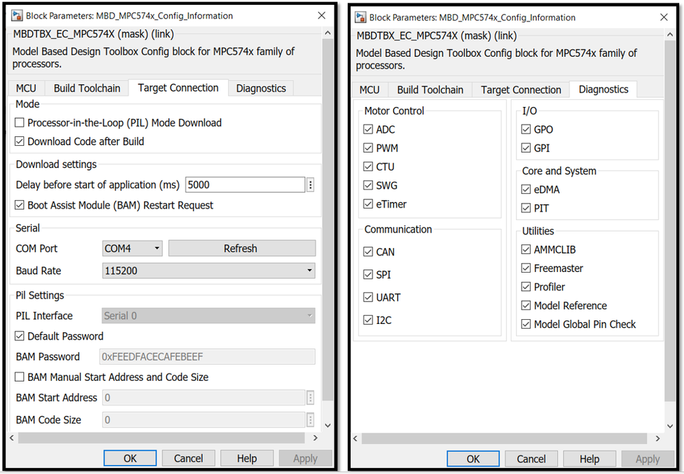

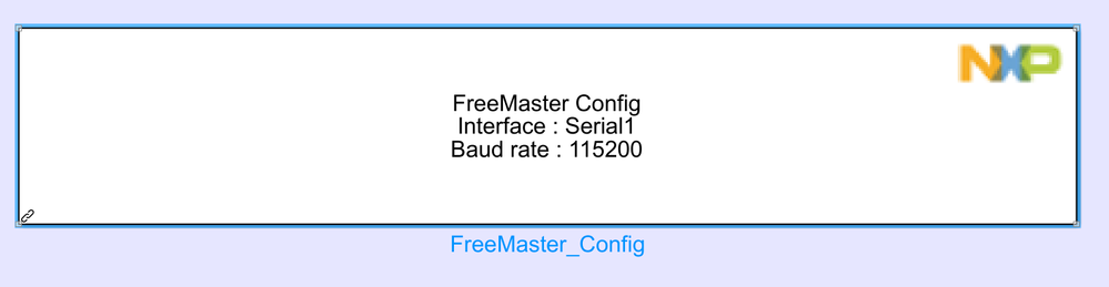

  • I tried again with the proper config of FreeMaster for MPC5744P rev E, see the attached pictures
I attached also screenshots of MBD_Toolbox Config block for MPC574x
  • I also compared the attached RFB with used RFB file. They are identical.
  • The used version of MBD Toolbox (in command window of Matlab 2018b I got the following message)
Model-Based Design Toolbox for MPC57xx Series         Version 3.0.0       (R2017a-R2018b) "
Unfortunately, I have got the same error "Can not detect the board information"
Many thanks for your help

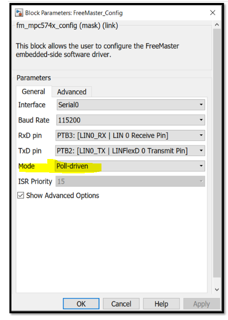

Another thing you can try is to set the FreeMaster mode from poll driven to Short interrupt.
I am not able to download the zip attached because of my antivirus (please add a password to the archive).
Now, you can also try to increase the Step Tick priority. The thing is that the step time of the model is triggered by the PIT channel 0: the isr priority is quite low, please increase it. Also, if the frequency of the step time is high the step time will not be able to work properly. Using the short interrupt might solve your problem.

I did what you proposed but unfortunately no success.

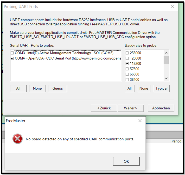

I tried also using FreeMASTER Connection Wizard and I have got
