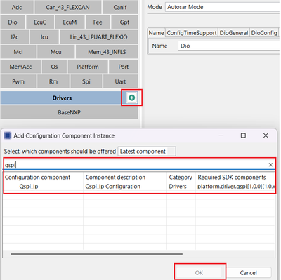

Since we do not support QuadSPI, your approach here would consist of adding the QSPI driver in the model's configuration, properly setting the parameters and all the necessary dependencies (e.g.: clocks, interrupts, pins etc.) and then using the QSPI protocol through custom code.
For header insertions you could use the Model Header block, and for actual code, you could use the Subsystem Initialize block. An alternative to using these blocks would be to change the board initialization file to add these includes and instructions.

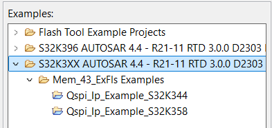

This thread also highlighted the fact that there's an S32 Design Studio example available that could serve as a starting point for your project:
