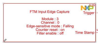

I've an application using the FTM Input Edge Capture Block to measure the tooth of a crankshaft.   Within the model is also an ADC Block to measure the voltage of the passive crankshaft sensor.  The application is working in Freemaster and with an oscilloscope.
Below a screenshot of the timestamp from the FTM Input Edge.
I've encountered two issues that I need help with.
Issue #1
As soon as I add a FTM Input TOR ISR to the model, the FTM Input Edge Capture appears in the application to generate rubbish (Freemaster + Oscilloscope).  Generally it looses all connection to the board in Freemaster as well. The Block has been used as in the example "ftm_hall_sensor_tof_s32k14x.slx".  It's the only change to the model.
What is the issue?
Issue #2

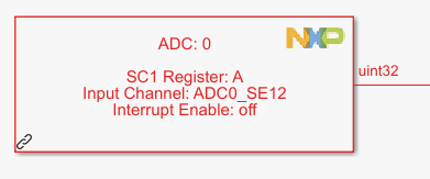

As soon as I change ADC Block to generate the data from the Potentiometer on the evaluation board (rather then look at the other sensor), the FTM Input Edge Capture appears in the application to generate rubbish or nothing at all. It's the only change to the model.
What is the issue?

The issue you are facing is caused by the Simulink priorities of the blocks, taken in account by the Embedded coder when generating the code. The FTM Input TOF ISR block has priority 1, while the FTM has no priority so it will first generate the code for the TOF ISR.
mariuslucianand_1-1635788854991.pngmariuslucianand_1-1635788854991.pngOf course, at first glance, there should be no issue here because both of the blocks are not executed every step time. But the problem is that in the initialize function, the code will start first to enable the TOF interrupt in the FTM and then to enable the FTM peripheral which causes the issue you may see with the board.
So please set the priority value 1 for the FTM input Edge Capture and priority 2 for the TOF ISR, and this should solve the issue.

Changing to Module 2 and another channel I've been able to make the ADC-Potentiometer work.
The TOF just causes the board to timeout and the code to not work at all.

Hallo @mariuslucianand
That was indeed the issue and makes perfect sense.
As an information point, the example provided in "ftm_hall_sensor_tof_s32k14x.slx" has the priority set as 1 for the "FTM Timer Overflow" Block.
Also, when I import the "FTM Timer Overflow" Block from the MBDT-Toolbox, by default the priority is set as 1.
Thanks for the help.
