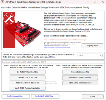

I'm encountering an error when using the "Verify MBD Toolbox Installation" button in the NXP Support Package for S32K3 (v1.6.0) on MATLAB R2024b.
Here’s the error trace:
>> NXP_Support_Package_S32K3
Error using contains
First argument must be text.
Error in NXP_Support_Package_S32K3/OpenToolbox_Callback (line 250)
                result(i) = contains(toolboxes(i).Name, 'NXP_MBDToolbox_S32K3');
Error in appdesigner.internal.service.AppManagementService/executeCallback (line 165)
                callback(appOrUserComponent, event);
Error in matlab.apps.AppBase>@(source,event)executeCallback(ams,app,callback,requiresEventData,event) (line 60)
            newCallback = @(source, event)executeCallback(ams, ...
Error in matlab.ui.internal.controller.uicontrol.UicontrolRedirectStrategy/executeCallback (line 203)
                    feval(callback{1}, src, event, callback{2:end});
Error in matlab.ui.internal.controller.uicontrol.PushButtonRedirectStrategy/handleCallbackFired (line 13)
            executeCallback(obj, src, event);
Error in matlab.ui.internal.controller.uicontrol.PushButtonRedirectStrategy>@(varargin)obj.handleCallbackFired(varargin{:}) (line 19)
            component.ButtonPushedFcn = @obj.handleCallbackFired;
Error using appdesservices.internal.interfaces.model.AbstractModel/executeUserCallback (line 282)
Error while evaluating Button PrivateButtonPushedFcn.
I did confirm manually if the toolbox is installed:
>> disp(matlab.addons.installedAddons)
               Name                Version    Enabled                  Identifier
    ___________________________    _______    _______    ______________________________________
    "NXP_Support_Package_S32K3"    "1.6.0"     true      "7addb8fc-087e-4490-b128-67745df27cab"
    "MATLAB Coder"                 "24.2"      true      "ME"
    "Simulink"                     "24.2"      true      "SL"
    "Simulink Coder"               "24.2"      true      "RT"
    "NXP_MBDToolbox_S32K3"         "1.6.0"     true      "7ac8b4ba-7b61-44b0-a91d-5925288823f8"
    "AUTOSAR Blockset"             "24.2"      true      "AS"
    "Stateflow"                    "24.2"      true      "SF"
    "Embedded Coder"               "24.2"      true      "EC"

Paul50000
Use shorter installation path. Go to settings->Add-ons on MATLAB home page and choose a smaller path for installation. i had the same issue, its now resolves. Currently i am using MATLAB 2025a version
Note: Before doing this uninstall the nxp ad ons and go to the default matlab toolbox folder and delete the nxp support folder of s32k3xx or s32k1xx, then choose new shorter location for installation (these things should be done manually) otherwise while installation you will get the message that uninstall or delete previously installed nxp toolbox
5,578件の閲覧回数
AlexCloutierDyname
Hello @as2025,
I just had the same problem with the 1.5.0 version.
In NXP_Support_Package_S32K3xx.m, replace these lines :
result(i) = contains(toolboxes(i).Name, 'NXP_MBDToolbox_S32K3xx');
with:
if isempty(toolboxes(i).Name)
else
end
In my case, it seems like the toolboxes variable had an empty member, which caused the error.
Your toolbox list seems to have this too (notice the empty space before the first toolbox in the list).
You need to do this replacement three times in the .m.
Hope this helps,
Alex
