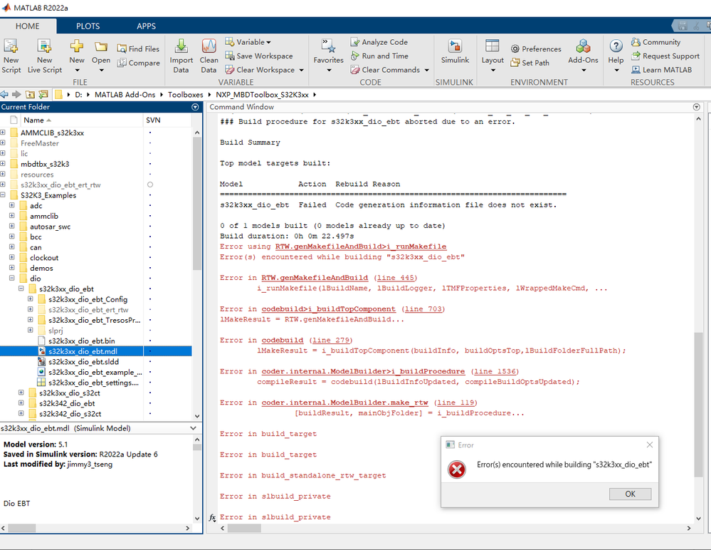

Jimmy18x2
I have a same problem now.
Our environment: MATLAB r2022a and EB Tresos 29.0.0
Different with this post.
1.  I try the \NXP_MBDToolbox_S32K3xx\S32K3_Examples\dio\s32k3xx_dio_ebt example not s32k3xx_dio_sc32ct.

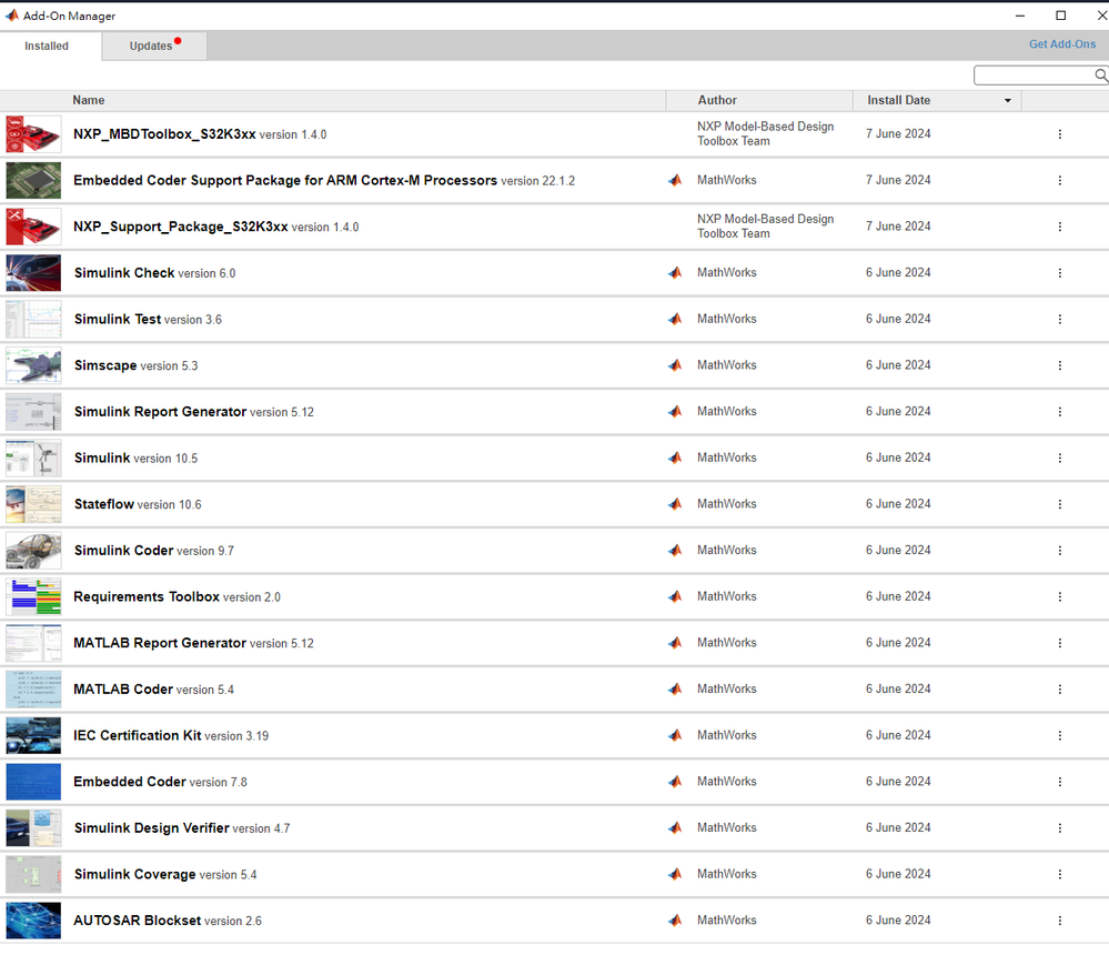

2. I had already changed the default work folder for MATLAB add ones by following that (To change the default installation folder, on the Home tab, in the Environment section, select Preferences > MATLAB > Add-Ons), and the path is shorter (D:\MATLAB Add-Ons).
This screen shows installed toolboxes now.

georgevictor
Hi, @Jimmy18x2,
The previous build of the s32k3xx_dio_sc32ct model failed due to a missing source file (Siul2_Port_Ip_Cfg.c).
Could you share with us the log from the s32k3xx_dio_ebt model build in a .txt file to check the error?
I've also noticed that you don't build the model in the same folder as its location. I recommend starting the build process when your current MATALB folder is the model's one so that the build artifacts, such as executable files, are created alongside the model.
Lastly, the MBDT for S32K3 version 1.5.0 has been recently released. You could install this version and rebuild the models to check if the issue persists.
