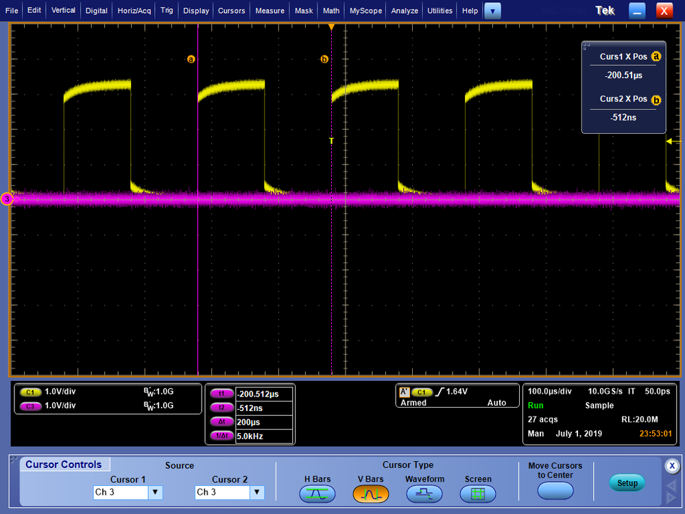

I experienced a very strange behavior with the ETimer- 0 (channel 5) in MBD tool box.
Currently I have 2 board with MPC5744P
1. MTRCKTSPS5744P (257-BGA Package)
2. DEVKIT -MPC5744P (144 LQFP Package)
I tried to synchronize with PWM in CTU and it works perfectly with 144 LQFP Pacakage, and I could see it on the scope.
On the other hand when I tried to change the package and measured the E-Timer Output on scope, I get flat line. (see snapshot, yellow for LQFP and purple for BGA)
I use J7 ( jumper setting for resolver excitation signal 2-3, in MTRCKTSPS5744P )  to see the Etimer Output.
I have attached the model (with 257-BGA config). Is it possible to provide an input.

Hello All
It was wrong pin selection in BGA package.
My apologies.
