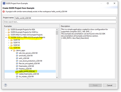

To do that, please install the S32DS for ARM alongside with the S32SDK for S32K1xx. You don't have to import the whole generated code in the S32DS. You can follow these steps:
1. Open S32DS for ARM
2. File -> New -> S32DS project from example. Choose hello_world_s32k144
3. once the project has been imported, go to flash button, Browse for the generated .elf, check Disable autobuild
4. Go to the next tab, Debugger, make sure you have a JTAG probe connected to the S32K and  detected( I am using the OpenSDA).
5. Press the Flash button, and now the code should run on the S32K.

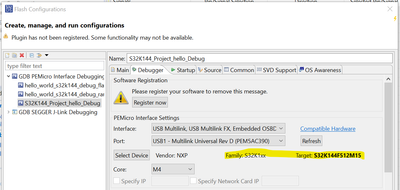

ranulf
@mariuslucianandThank you for your help. I got an error on step 5, after pressing Flash. Unfortunately, the information in the error message was not very helpful. I am using the USB Multilink.
I tried to flash a few times after changing different options. I got the same error message after every attempt. There were 2 device options for the S32K144 and I tried them both.

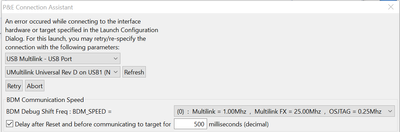

ranulf
@mariuslucianandAn internet search got me to the following NXP community answer.  https://community.nxp.com/t5/S32K/Error-while-launching-command-version/m-p/689231/highlight/true
That seemed to change something and now I get a different error message.
3,401 Views
mariuslucianand
Hello @ranulf ,
I usually get this error when the controller is not powered up or the JTAG probe is connected reversed. In any case, the probe can not access the controller. So please check first the power. Also, Multilink has two LEDs, I think both of them has to be powered up when the connections are fine.

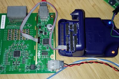

ranulf
Thank you @mariuslucianand
It turns out that the orientation of one of the plugs for the cable connecting the board to the Multilink was reversed.  Good suggestion. The correct orientation is shown in the photo. I have now loaded simple Simulink code that flashes the LED. It works!
