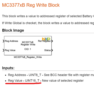

I'm referring to the block at NXP Model-Based Design Toolbox for S32K1xx MCUs/External Devices/Battery Management System/BMS/MC3377xB Register Write
@mariuslucianand  The block in Simulink shows a data type mismatch between the constant (uint16) feeding Reg Value the Reg Value port (uint8). See below.
The documentation shows that Reg Value is a UINT16. See below.
Which is in error? I think the block port is in error because register values have 16 bits.

Hello @ranulf,
You are right, the issue is with the block not with the documentation.
To get the right input value type, please replace the mc3377xb_s32k_reg_write.mexw64 file, from the archive attached to the {Toolbox install path}\external_devices\blocks\mc3377xb.
To find the Toolbox install path, please type the mbd_find_s32k_root command in Matlab.

Hi @mariuslucianand ,
I followed your instructions and now the block Reg Value port has the correct data type. However, I have not been successful in changing register values. I can read them but not change them. This perhaps is a different question and issue.
