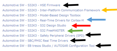

hayaoki7
Hello
Red arrow: Installed considering the cooperation with S32DS
Blue arrow: Included in MBDT
Green arrow: FreeMaster is in the MBDT folder, but it's a driver and should be installed.
Orange arrow: Does IPC need to be installed?
Black arrow: No installation required
S32DS may not be necessary, but it can be used when exporting a project from MBDT.
Settings such as config are installed by MBDT.
I understand that, but it is correct
Hayaoki7
